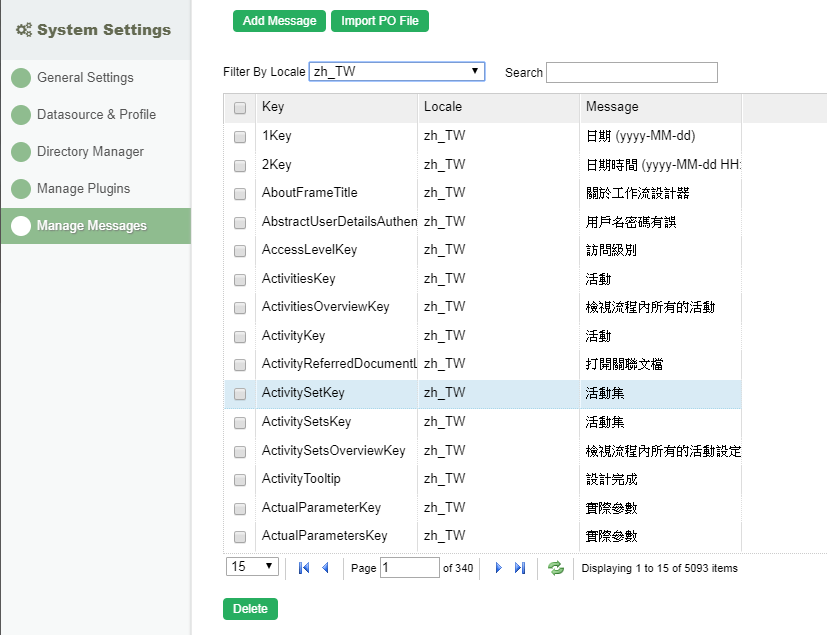

My default zh_TW translation at "Manage Messages" page is blank after installed Joget V6
All the following translations of zh_TW come from "import PO file" action and they looked fine.
Did your joget version include zh_TW translation already after installed?
Hi there, Yes, they are bundled. You can look into "\apache-tomcat-8.5.23\webapps\jw\WEB-INF\classes" and find some message bundle there that is already loaded in Joget by default. We included, ar,en,hu,ko,ms,th,zh_CN, and zh_TW. The reason why it is empty in "Manage Messages" because it is for after-market (after installation) messages to be loaded after the installations. These entries will be stored in the database rather be in the file system. Thanks. Hugo
Hi, I tried to switch to zh_TW directly in the Settings and it looks fine. The default zh_TW translation seems quite complete, perhaps the one in the community translation site is incorrect.

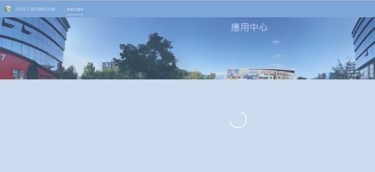

Dear all Experts,
I am new to Joget. I would like to add chinese language to Joget UI platform.
After I import PO file of zh_TW message to system from http://translate.joget.org/
When I changed the system Locale to "zh_TW", and relogin the system.
The Joget App centre Home screen keep hanging and cannot do anything like as following.
I need to force to use en_US during login by input the following site so that I can change the system locale back
localhost:8080/jw/web/desktop?_lang=en_US
Anyone has similar case with solution ?
Many thanks~.
