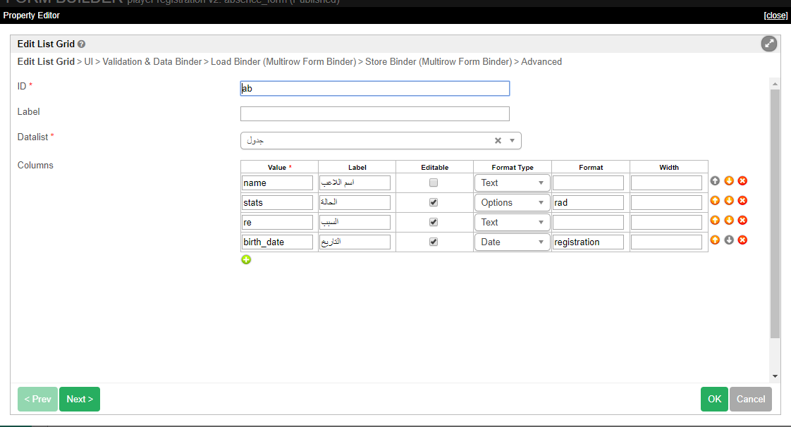

I am using list grid and i have a date filed is there a way i can use date picker when i edit the date ?
i tried setting the format to a form id with a date filed but it doesn't work it appears like a text filed
Hi there, just a correction. From the look of it, it seems that you are using https://dev.joget.org/community/display/KBv6/Grid and not https://dev.joget.org/community/display/KBv6/List+Grid as you claimed.

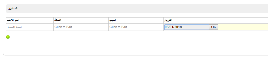

hi no i'am using list grid ,i am retrieving the data from a list i edited the question with a screenshot of the list grid
Hi, I do not think it can. Only Advanced Grid or Spreadsheet support those editors.
