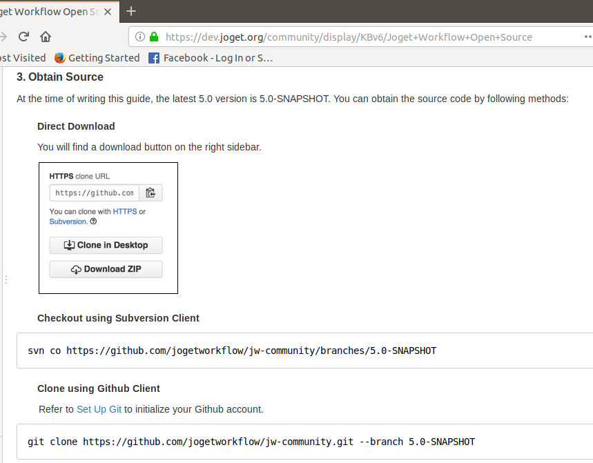

Hi, v6-SNAPSHOT is the default branch in https://github.com/jogetworkflow/jw-community. Do you follow the guide in Joget Workflow Open Source?
Hello, Yes, I did. I also tried to rebuild it, just now. Still the same error.
Please check the image I uploaded as an answer, as I can't upload images in the comments. This screenshot is from version 6's source code tutorial, it specifies that the last version uploaded is version 5.
I'm trying to build Joget on my computer (follwing this tutorial: Build Source Code on Linux)
However, only version 5 is available in the repository.
