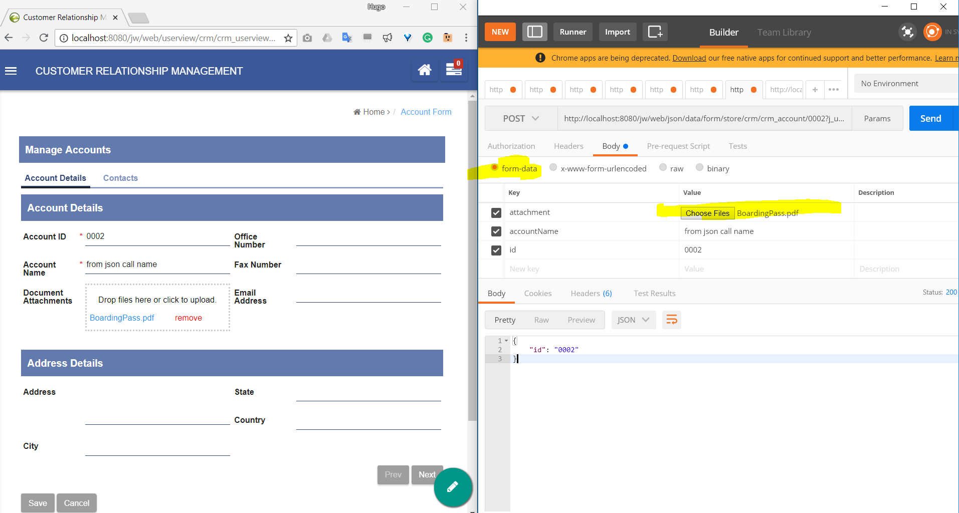

      I'm using JSON API#web/json/data/form/store/(*:appId)/(*:formId)/(*:primaryKeyValue) and trying from postman to show example that it works this way.
      curl -X POST \
      'http://localhost:8080/jw/web/json/data/form/store/crm/crm_account/0002?j_username=admin&j_password=admin' \
      -H 'content-type: multipart/form-data; boundary=----WebKitFormBoundary7MA4YWxkTrZu0gW' \
      -F attachment=@BoardingPass.pdf \
      -F 'accountName=from json call name' \
      -F id=0002
