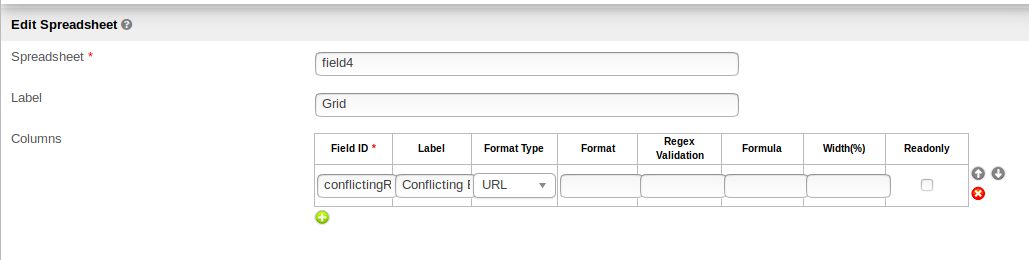

On spreadsheet design properties screen:
When you run the Spreadsheet form, key in:

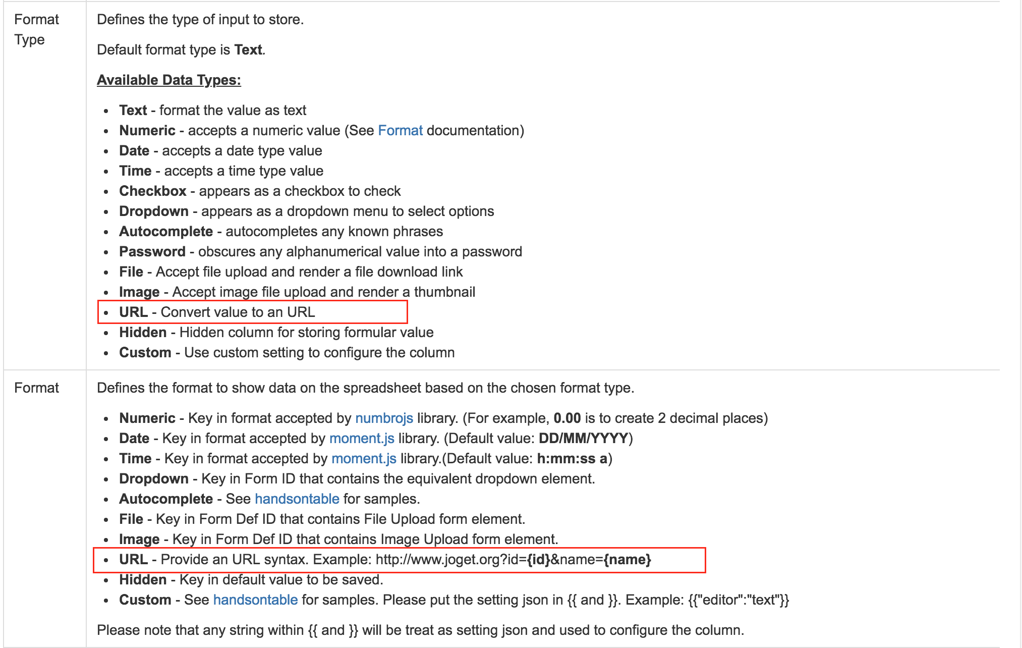

Refer to Spreadsheet, the URL format type is used to convert a value to URL following the URL pattern in "Format".
For example, to convert an id field to URL
Field ID : id
Label : ID
Format Type : URL
Format: http://10.1.12.224/jw/web/userview/jmrb/v/_/form?_mode=edit&id={id}

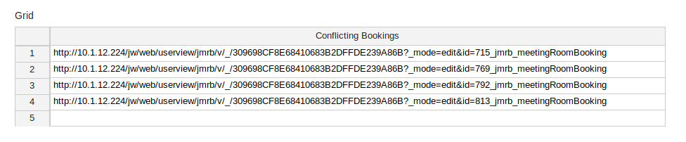

Hi Owen, That's exactly what I did, but it doesn't work. Could it be that the formatting doesn't work unless the field is bound to another form field?
Hello,
This is how urls appear in spreadsheet, and they can't be clicked. I have to copy and paste them.
This is the settings for the spreadsheet:
