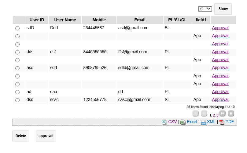

This part is not clearly described - i have designed it like selecting a field from datalist and then i proceed by clicking approval button

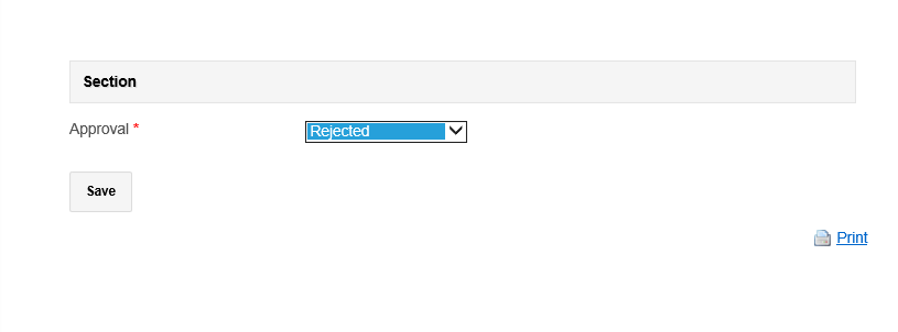

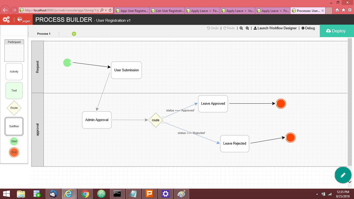

Hugo, In the datalist attachment u will find list of cumulative values, on selecting each field in the datalist and proceed further by clicking approval hyperlink which will direct to (Apprroveform.png)- when i save this form it is generated as another field in the datalist . I want to generate it has a single field. This is my worklfow(workflow.png)

I have created a data list (datalist.png), in this data list- i can find two types of data added as each field 1) data from submit for, i have designed it like selecting a field from datalist and then i proceed by clicking approval button which will direct to (Apprroveform.png)- when i save this form it is generated as another field in the datalist . I want to generate it has a single field.
