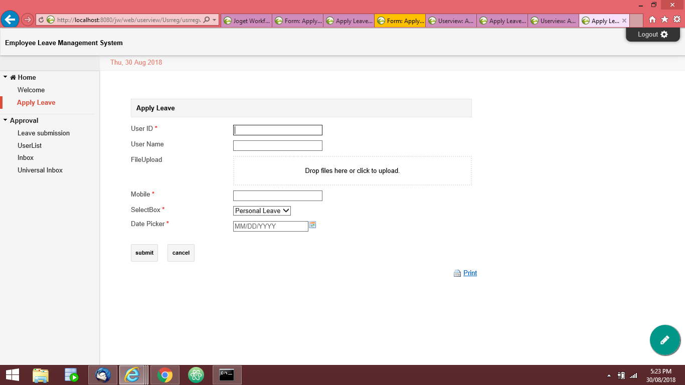

This is an apply leave form which i have designed
When i submit this form i dnt get any message in inbox
Can i generate a message in inbox, if yes, how?

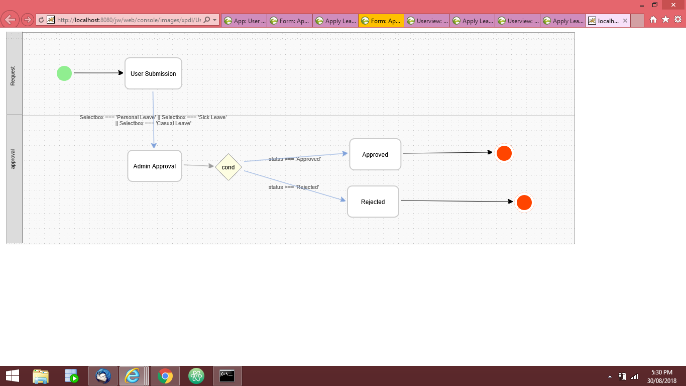

This is my workflow:
