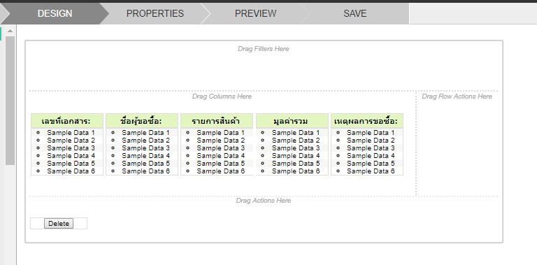

First of all, all grid-like elements in Joget are stored as JSON by default.
The first step would be to configure the spreadsheet and change both load and store binder to Multirow Form Binder. Configure the load/store binder to a newly created form (to be loaded from and stored into the form's table) and it's foreign key (unique and distinct identifier of your table records).
Then, you can use the Nested Datalist Formatter, which is a new feature for Joget Workflow V6, to allow easy retrieval and reference of nested grid data for your end user.

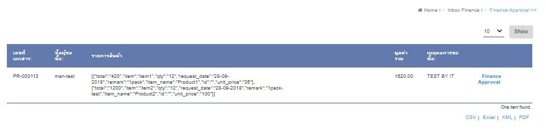

How to set array json to datalist

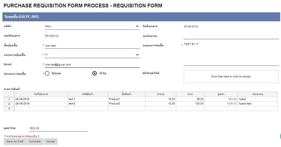

I'am map datalist from spreadsheet data
but datalaist show array json
i want to split array json to column in datalist
p้lease expert send how to way to config it.
