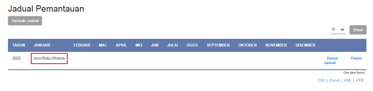

You can use this Datalist Column Formatter to beautify the multi-value column: Bean Shell Formatter
There are few sample scripts in the guide on how to retrieve the values. You can write simple Java to append new line "/n" after every string in your desired format.
Hope this helps!

Thank you. it really help me. i edit the java script to made a simple changes to my format. This is my script:
//import the necessary classes
import org.joget.apps.datalist.service.DataListService;
import org.joget.apps.app.service.AppUtil;
DataListService dataListService = (DataListService) AppUtil.getApplicationContext().getBean("dataListService");
//since this entire bean shell applies to every row, "row" is automatically iterated here.
//"name" is the column id
String value = dataListService.evaluateColumnValueFromRow(row, "jan");
return value.replaceAll(";", "\n");
Hi, i want to make my data in datalist look beatiful. i want my multiple data become new line.
