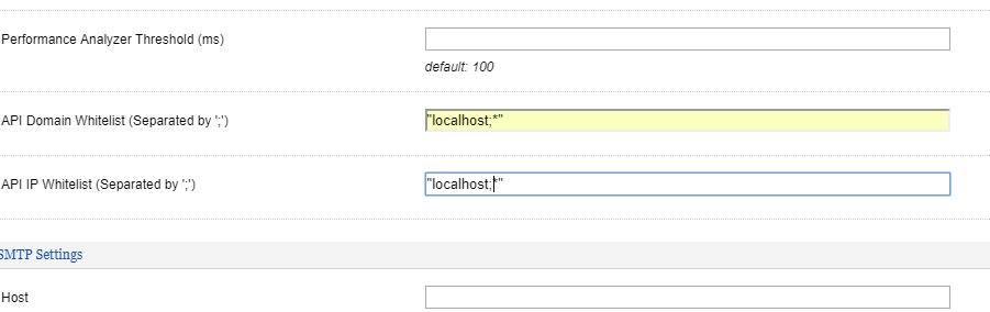

I have done the below settings on my local joget server to include the localhost in whitelist domain.
Now, when I use any of the json api's, I am always getting 400.
http://localhost:8092/jw/web/json/workflow/package/list
Error:
{"error":{"date":"Tue Sep 25 18:55:45 IST 2018","code":"400","message":""}}
Below error is logged in console.
I have tried with GET and POST reequests but its the same result. So What I am missing here?

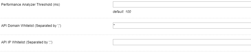

      For API IP whitelist, leave it blank. For API domain whitelist, just type in --> localhost Hope this helps.
      1. parashuram
        justin I did the same but it worked by giving * in the domain list.For localhost it did not work. Added ss in below comment. Thank you so much for your time.
      2. Anton Kuzmin
        Same here. * worked, localhost didn't
    2.
      Same here. Localhost didn't work. But when gave *, CSRF error stopped coming.
