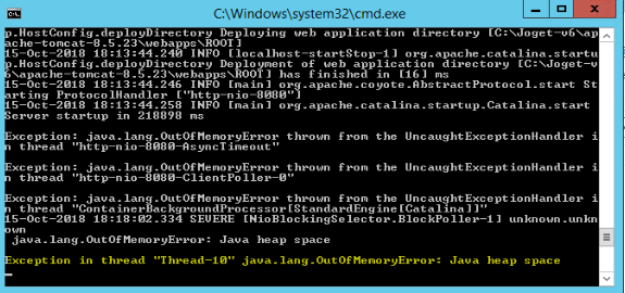

Hi, you mentioned "However for now, it seems that 1024m, is the maximum memory, any insights for another memory extension?". Is there a reason why 1024m is the maximum memory? You can set it much bigger as long as you have sufficient physical memory. Also you should ensure that there is no memory or resource leak based on Performance Optimization and Scalability Tips#EliminateResourceLeakage(Memory,DatabaseConnections,Files,Network,etc)

Hoping someone could assist me with this error, I'm using Joget Community Edition V6 running on Windows Server 2012 64bit. Currently I already published 4 projects on my workflow.
For the 5th project I was working for our Engineering Forms Job Order(with 10 modules inside), However the workflow stops to respond which ends up for me to restart joget services. Afterwards, It shows me the below.
Please take note that I already encountered this issue before and what I did is to extend the java memory from 512m to 1024m from start.bat
However for now, it seems that 1024m, is the maximum memory, any insights for another memory extension? hoping someone could assists.
