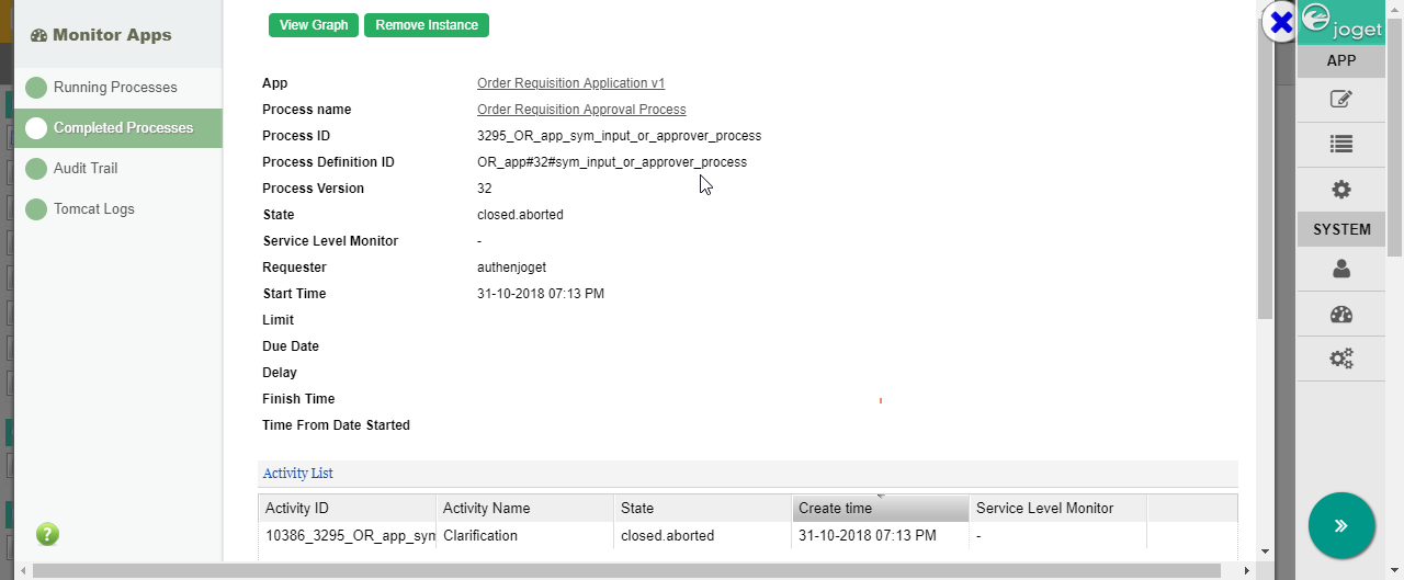

We have noticed that once we update process, JOGET will close (abort) all running processID and create new processID instead.
Amazing things is that when we open Data List inbox, we found that all running process still be shown correctly but when we track into table which keep process data, id column still be old processID.
Our problem point is that when we can not bring (old)processID in table to check with running process in Monitor screen because it was "close.abort" arleady.
Does any way to track that what running processID was created from the old one?
