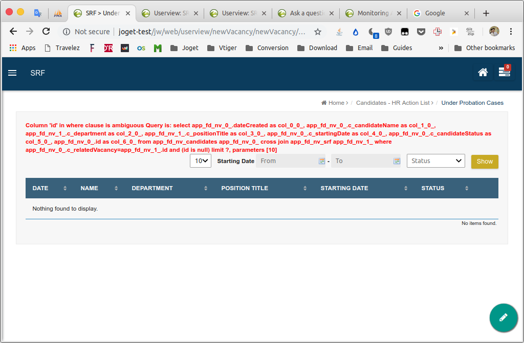

It turns out that dropping form tables of the app was the problem. I usually drop the tables instead of truncating them when I clear the app
Hi, do you have some kind of custom SQL or HQL filter condition that you can check? I have not come across such a cross join statement in use before.
Sometimes I want to clear all data of an app in the development phase. Here's how I do it:
1. I delete all running and completed processes using "monitor" of the admin bar
2. I clear all form tables using a database management tool
Sometimes, I came across this error, and I haven't been able to understand why it happens: Column 'id' in where clause is ambiguous Query
