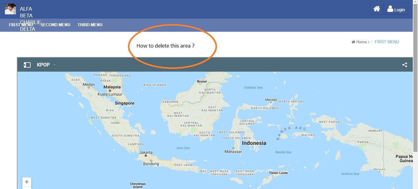

Halo Expert,
How to erase an upper space in each forms with V6 Universal Theme ?
Thank you

Try to inspect the DOM in chrome.
Right click, inspect element to find the element that gives it the padding.
Then, add CSS to remove the padding into the userview theme CSS inside its properties.
