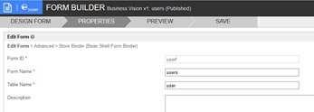

I tried to use data populating Bean shell script given as sample in my application.
1 - Then I created this form
2 - I copied and pasted the bellow script in Strore binder option of the form.

3 - When I test form submitting, this is what I get:
Any HELP?
THANKS very Much
It says there's error in executing script. Have you checked the server log?
