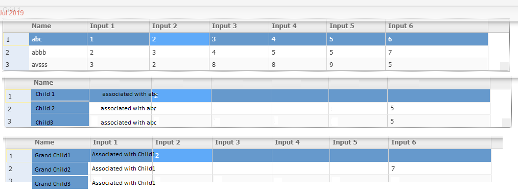

Example Student Parent Table Course Child Table and Lectures Grandchild Table. Each of them dependent on the selection of row of last table.

How to make three related tables show records. As an example masterDetail.png. Row selection on first table should populate row in 2nd table a row selection in 2nd table should populate rows in 3rd table.These would be read only Tables.
