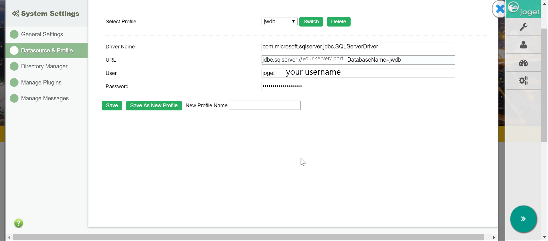

Please see sample screen short.
I've tried configuring that part before, and it's still an error. but I have not changed the select profile section. so how do you change the profile to jwdb?
thank you for giving me a hint.
Don't forget to make sure that sql server DB must create "jwdb" schema (with empty table is OK) before you setup profile.
