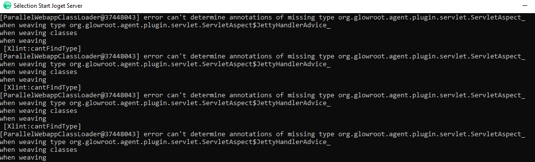

Do check if your joget-start.bat / sh has this line:
set JAVA_OPTS=-Xmx768M -Dwflow.home=./wflow/ -javaagent:./wflow/aspectjweaver-1.8.5.jar -javaagent:./wflow/glowroot/glowroot.jar
Maybe perform a new download and perform a fresh install into a new folder (or rename yr old Joget folder).
Hello,
I am trying to use Joget DX Beta for testing. The installation went correctly (i think) but when launching the platform i get a bunch of errors :
Launch completes but when trying to reach localhost:8080/jw I get an HTTP 404 - Not Found error.
Any idea?
Thank you
