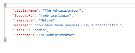

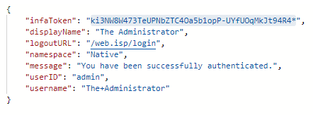

Done with Postman (e.g. call the same API call twice as above):
2nd call – Note that it will not return token since I just got it
