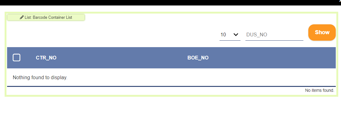

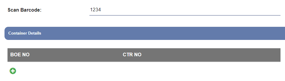

When I press enter after entering value in scan barcode field (Pic 1), it will open the list grid (Pic 2). When I return from list grid after selecting rows, focus should back to scan barcode field itself. Please help.
Pic 1.
Pic 2

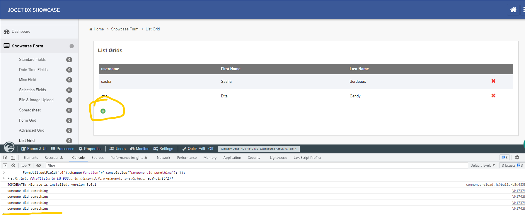

This might helps, at least, you know how to attach event binding.
I'm using the showcase app, and the list grid id is "LG"
FormUtil.getField("LG").change(function(){ console.log("someone did something"); });
With this, you can then proceed to perform the next step.
I am opening list grid from a button. Once I select rows from data list, selected rows are appearing in the list grid. How to set focus in one column when I close the data list.
The list itself is read only. What will happen after you "set focus on a column"? What is your end goal?
