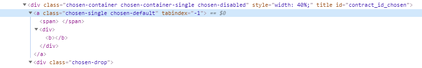

I think II found the problem but I didn't find the solution
when "Use AJAX for cascade options?" is checked I get an empty box when uncheked the code above works. what's the solution to this?
- Hamid Zahrir
definetly AJAX
with AJAX enabled
and when disabled
as you can see the AJAX override the chosen-single with chosen-default
how can i disable ajax then the box is disabled
