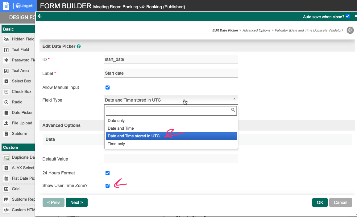

In your date picker, choose UTC. This will make sure the date/time is accurate regardless of DST or not.
The datetime stored inside DB should not point to a timezone that changes at different time of the year (a concept we call a single source of truth)
This is so that the recipient can translate to the local timezone easily.
If the datetime in DB observes DST sometimes and sometimes not, this would make translating to local timezone unnecessarily complex.
It should point to UTC. Read more https://blog.invertedsoftware.com/2018/08/14/youre-doing-it-wrong-stop-making-a-mess-out-of-your-apps-time-zones-with-utc/
