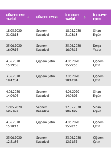

      I've exported and imported again. The fields ( Date Created / Date Modified ) are transferred now BUT it seems like they are the same : "Date Modified" has been replaced with "Date Created".

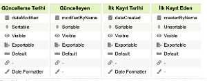

      This is the original data:
      "Güncelleme Tarihi" = dateModified
      "İlk Kayıt Tarihi"= dateCreated
      This is the data after the import:
      How can I fix this problem?

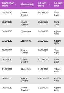

      The problem has been fixed by Joget I guess. I have imported the app today and the "Date Modified" fields were correctly imported.
