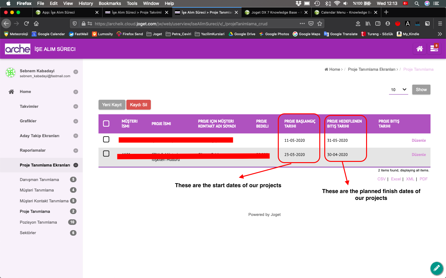

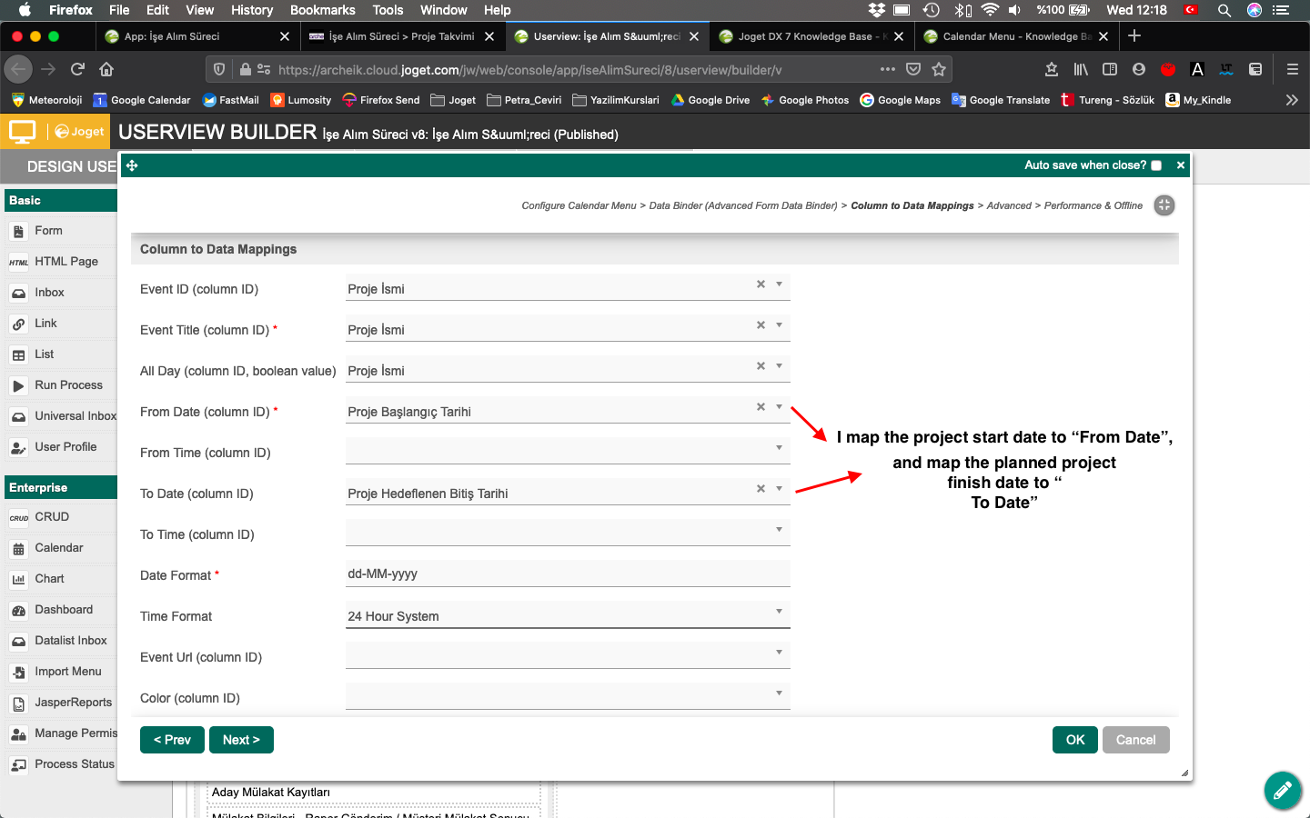

I have a form in which the project start and finishing dates are chosen. I use these dates in the Calendar item in the userview. We are using Joget DX On-Demand.

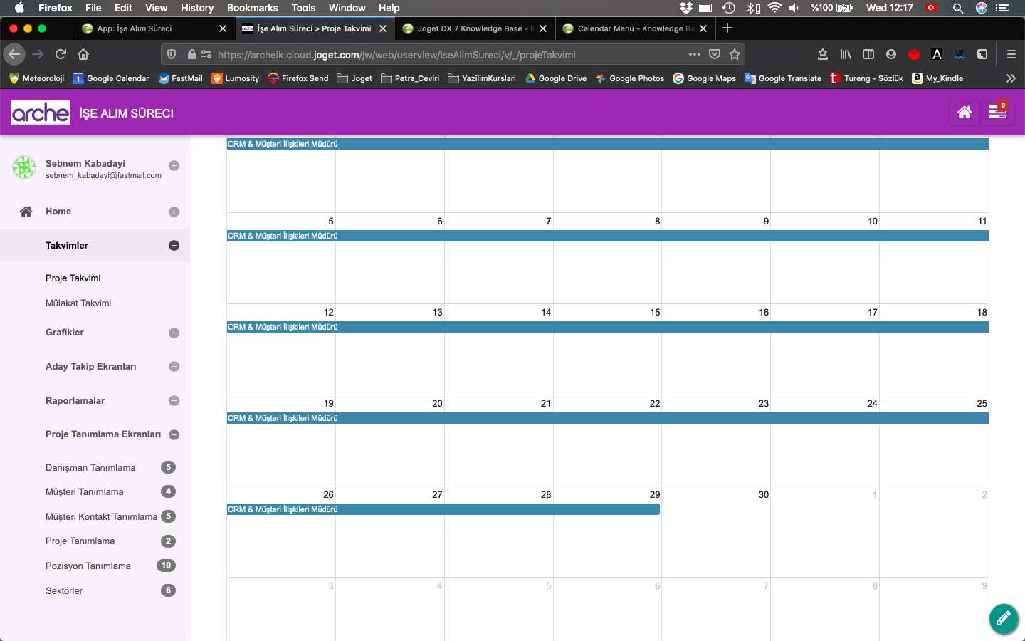

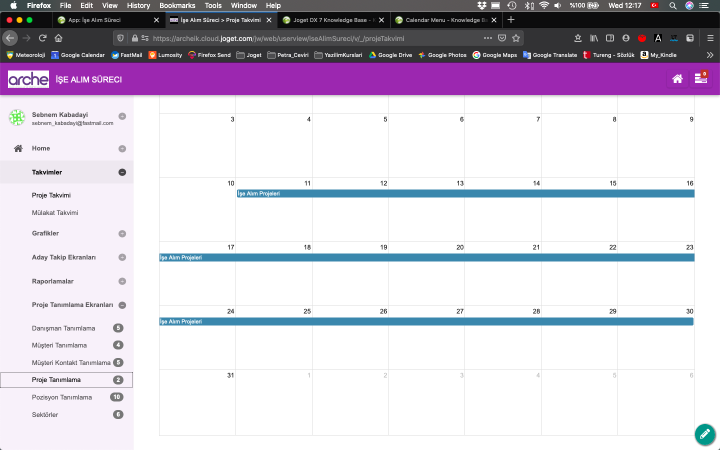

The "To Date" values are shown one day earlier on the Calendar view. I couldn't find a variable to define include or exclude the "To Date".
