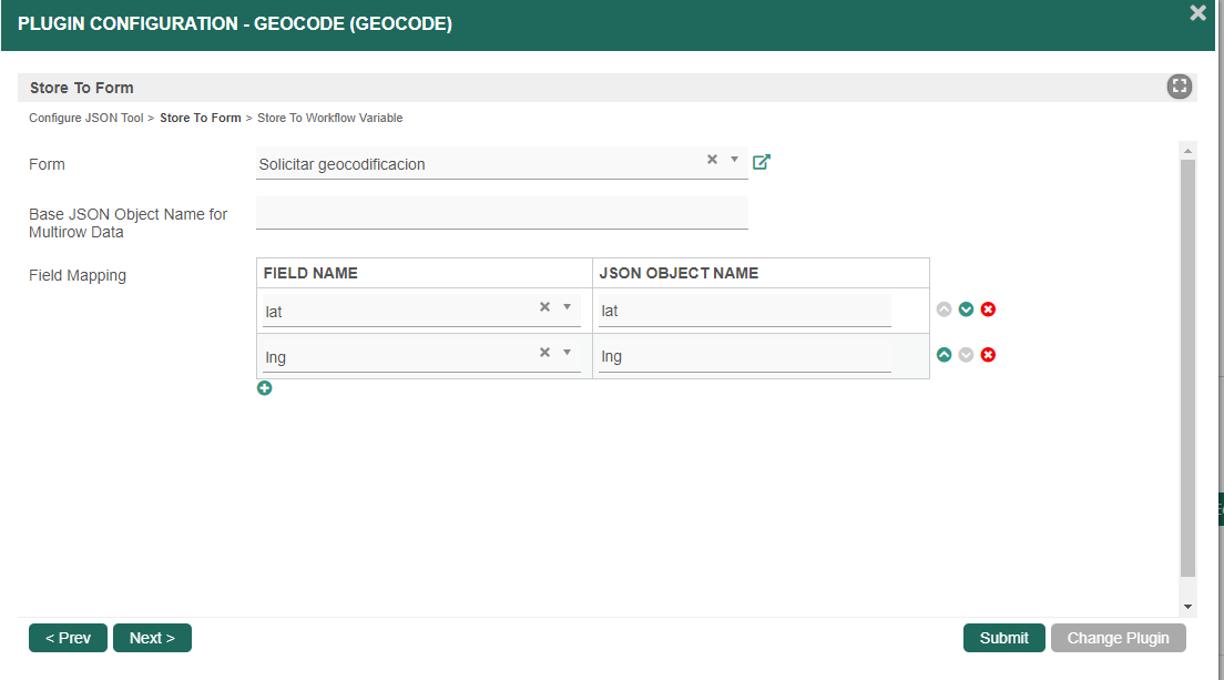

In the Json tool configuration,fill this data

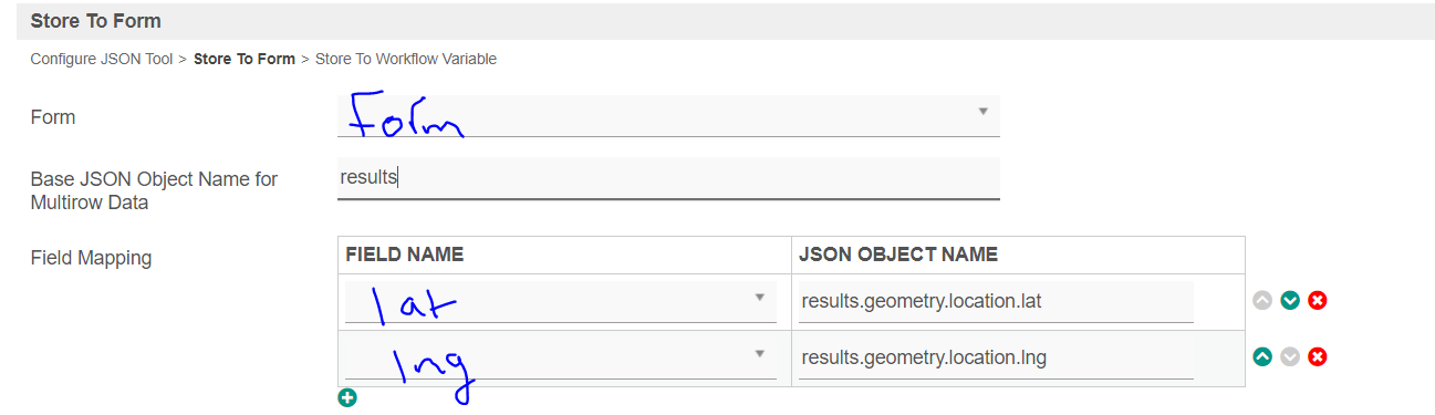

hi, referring to JSON Tool, i think you can try use `results.geometry.location.lat` and `results.geometry.location.lng`.

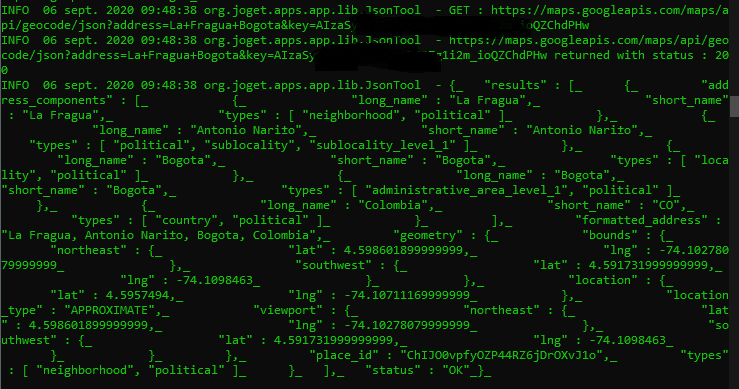

Hi, I am making a connection to the google geocoding API, through the JSON plugin (DX community edition). The connection can be done successfully, but it has not been possible to write the results "lng" and "lat" in the fields intended for it in the form designated for it. Also, I see that there are several possibilities for "lat" and "lng". How do I refer specifically to, for example those associated with geometry / location?
I am not very familiar with the expected behavior, but is it correct that the response format includes the characters "_"? (as seen in the image below). Does that prevent the results from being read well? Any recommendation?

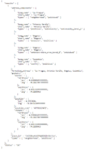

Here the response as seen in a browser:

INFO 06 sept. 2020 09:48:38 org.joget.apps.app.lib.JsonTool - GET : https://maps.googleapis.com/maps/api/geocode/json?address=La+Fragua+Bogota&key=AI....XXXXXXXXXXXXXXXXXXXXXXXXXXX...w INFO 06 sept. 2020 09:48:38 org.joget.apps.app.lib.JsonTool - https://maps.googleapis.com/maps/api/geocode/json?address=La+Fragua+Bogota&key=AI....XXXXXXXXXXXXXXXXXXXXXXXXXXX...w returned with status : 200 INFO 06 sept. 2020 09:48:38 org.joget.apps.app.lib.JsonTool - {_ "results" : [_ {_ "address_components" : [_ {_ "long_name" : "La Fragua",_ "short_name" : "La Fragua",_ "types" : [ "neighborhood", "political" ]_ },_ {_ "long_name" : "Antonio Nari±o",_ "short_name" : "Antonio Nari±o",_ "types" : [ "political", "sublocality", "sublocality_level_1" ]_ },_ {_ "long_name" : "Bogota",_ "short_name" : "Bogota",_ "types" : [ "locality", "political" ]_ },_ {_ "long_name" : "Bogota",_ "short_name" : "Bogota",_ "types" : [ "administrative_area_level_1", "political" ]_ },_ {_ "long_name" : "Colombia",_ "short_name" : "CO",_ "types" : [ "country", "political" ]_ }_ ],_ "formatted_address" : "La Fragua, Antonio Nari±o, Bogota, Colombia",_ "geometry" : {_ "bounds" : {_ "northeast" : {_ "lat" : 4.598601899999999,_ "lng" : -74.10278079999999_ },_ "southwest" : {_ "lat" : 4.591731999999999,_ "lng" : -74.1098463_ }_ },_ "location" : {_ "lat" : 4.5957494,_ "lng" : -74.10711169999999_ },_ "location_type" : "APPROXIMATE",_ "viewport" : {_ "northeast" : {_ "lat" : 4.598601899999999,_ "lng" : -74.10278079999999_ },_ "southwest" : {_ "lat" : 4.591731999999999,_ "lng" : -74.1098463_ }_ }_ },_ "place_id" : "ChIJO0vpfyOZP44RZ6jDrOXvJ1o",_ "types" : [ "neighborhood", "political" ]_ }_ ],_ "status" : "OK"_}_This is how the plugin was configured
