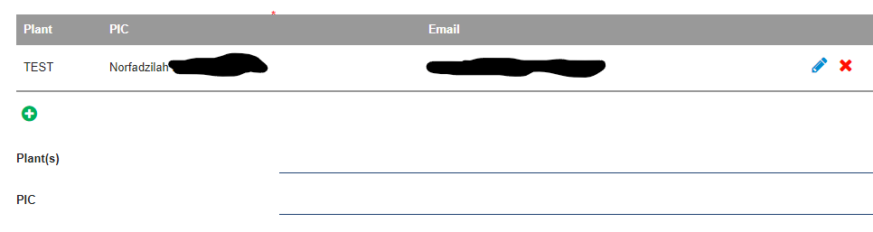

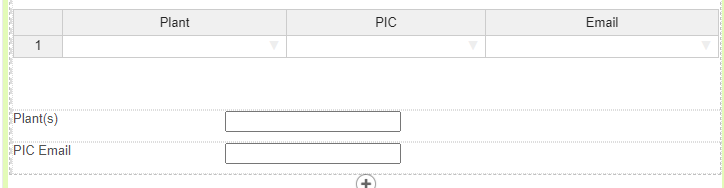

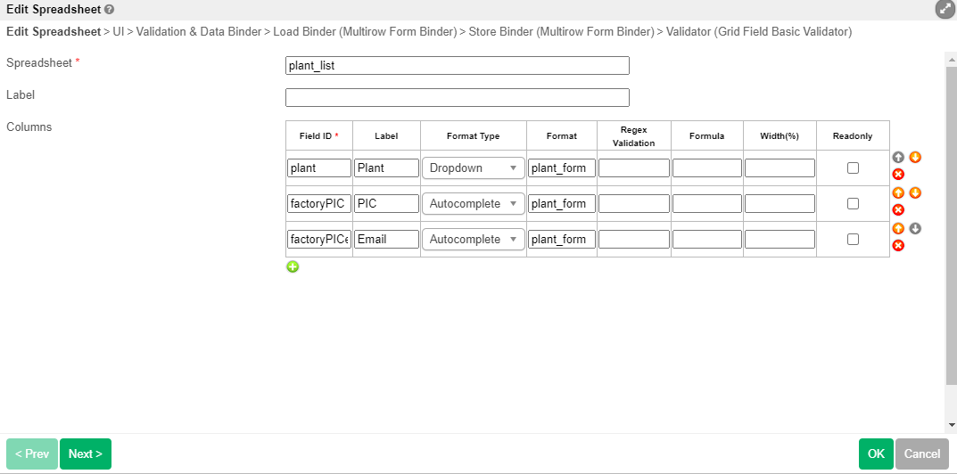

How to store data from spreadsheet to a field?
For example, in spreadsheet I choose plants as ABC, DEF, GHI then the pic name and email will auto filled.
And I want Plant(s) and PIC Email fields to also get the value from spreadsheet.
Thank you!

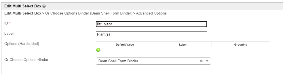

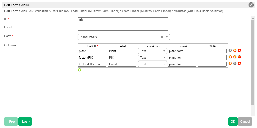

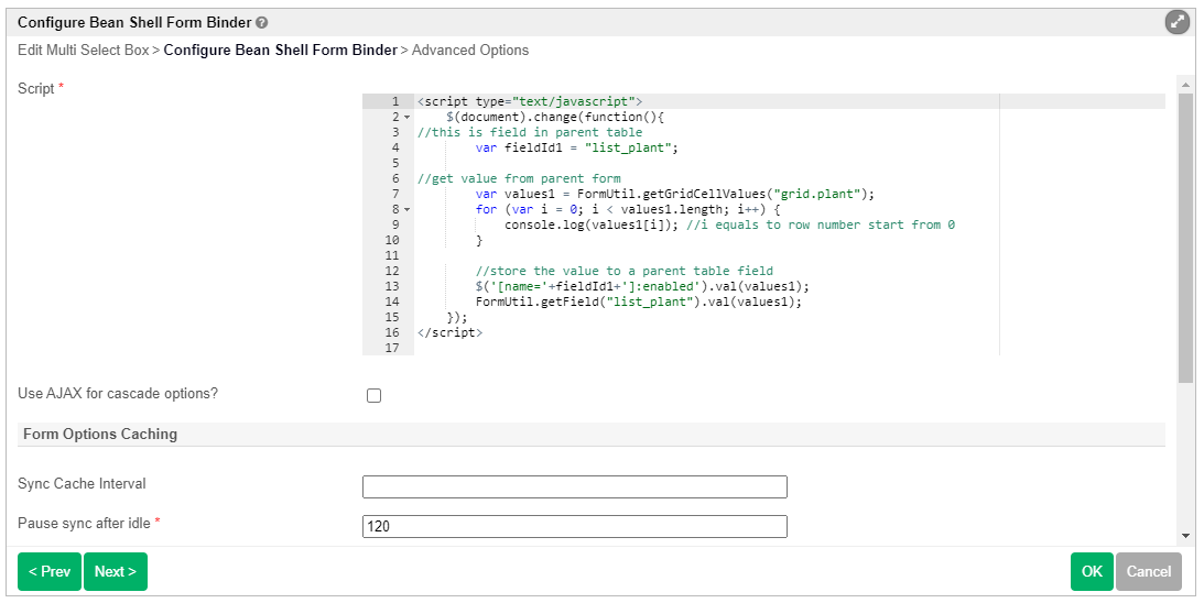

        I change my spreadsheet to grid and try the code but it did not return the grid data to field Plant(s) and PIC as an array.
        Here what I did;
        Thank you!
      2. Chris Angel
        As mentioned, my script is Javascript, not Java (Bean Shell). Place code in custom html form element.
