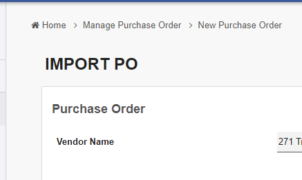

When a run a process, the form shows the name of the process.... how does one turn this off?

        so the inspection yelds:
        <div class="runProcess-body-header">
        Submit PO Invoice
        </div>
        how would I use this to change the userview? does it go into the theme?
