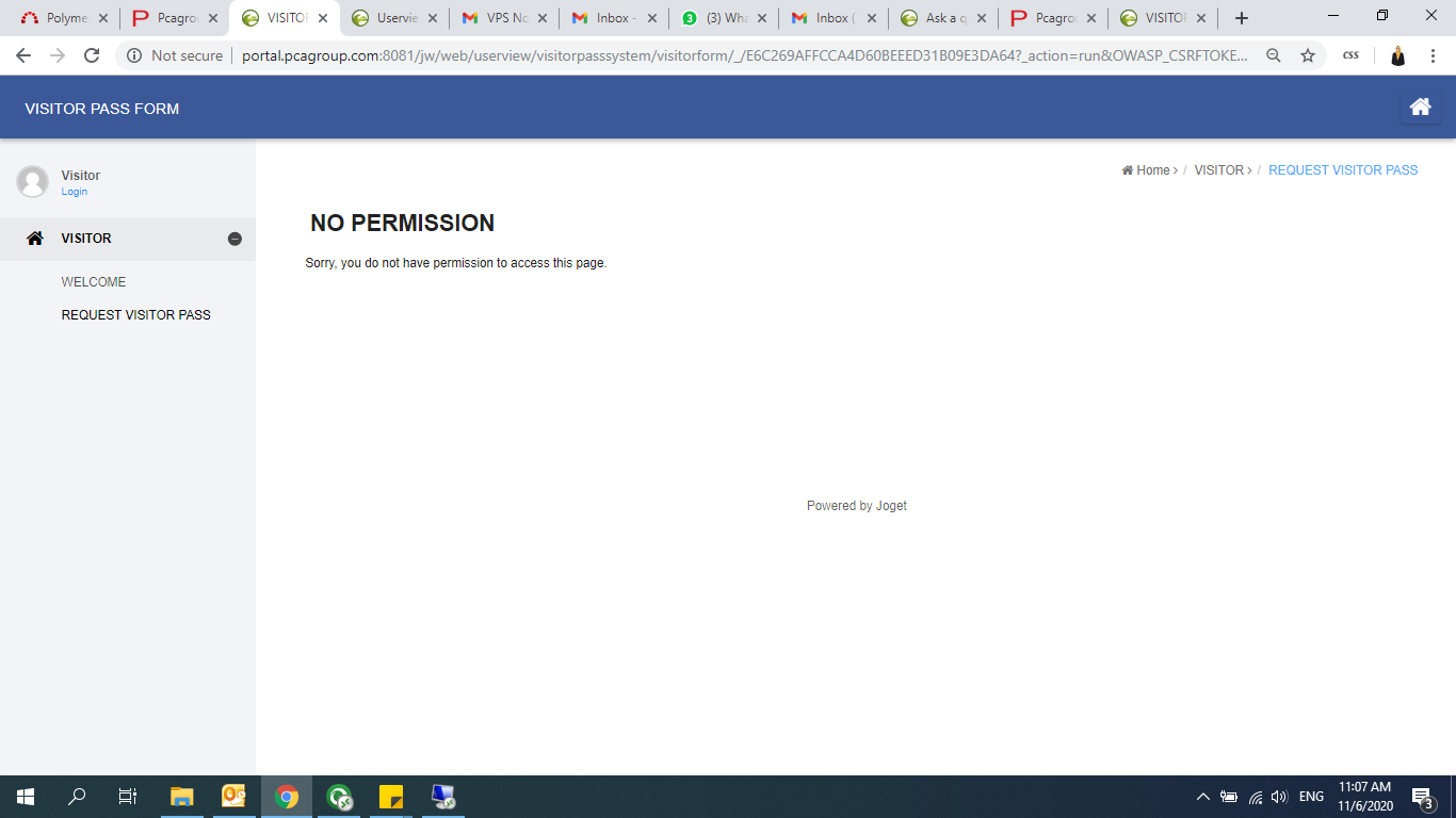

this picture is when i created different userview. I have set this userview as anonymous but the form cannot be open.

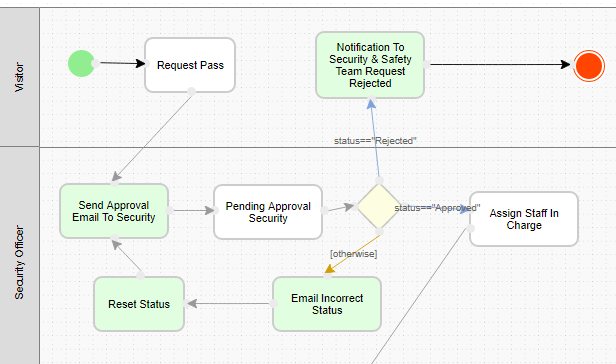

This is the workflow.
How can I fix this and get the link for visitor form because i want to create the url QR code for that form?

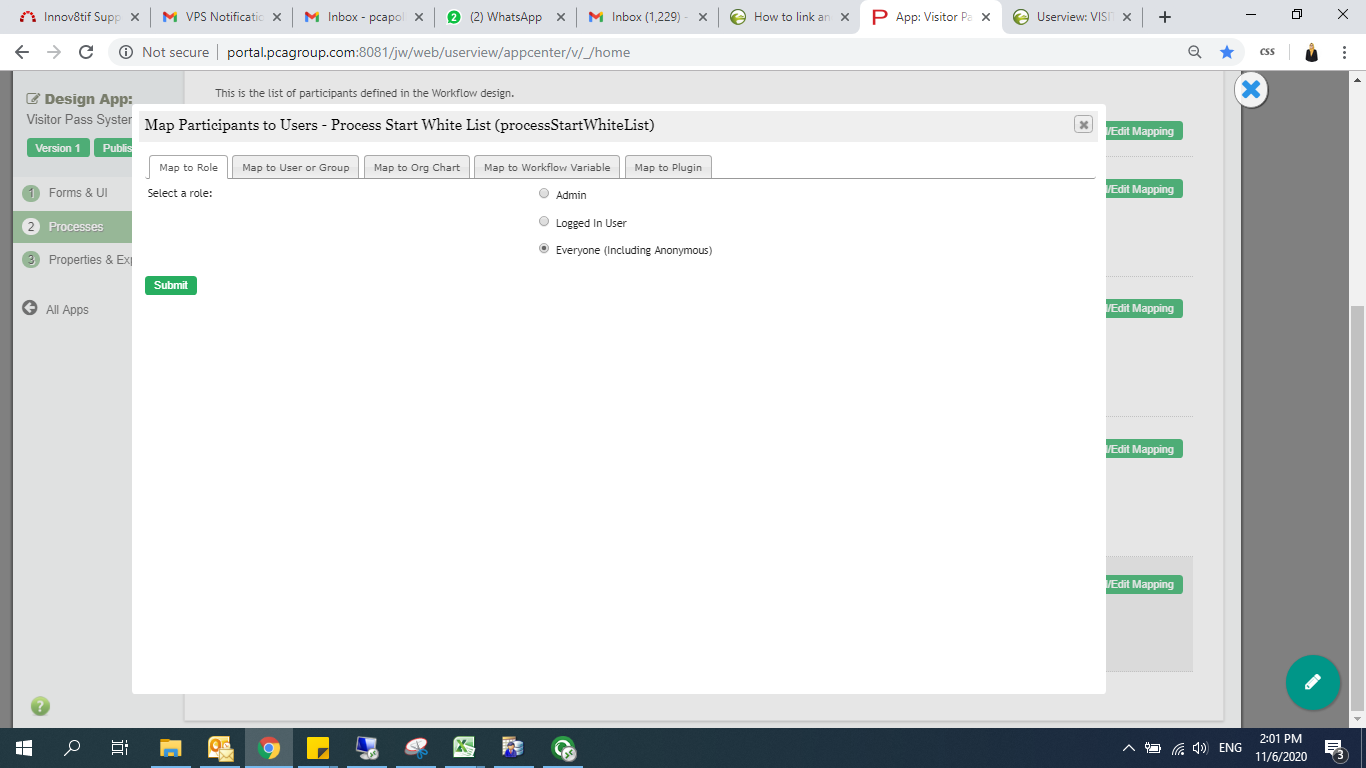

      Presumably, the form is mapped to a process? if so, at design app > processes > selected process > Map participants to Users, scroll all the way down and change the permission under *Process Start White List*. By default, its set to admin. This determines who can start the process
      1. Nadh
        is this right?
      2. Ian
        yeah, if you want anonymous users (non-login users) to start your process. can you start the process now?
      3. Nadh
        ok done.. tq so much for your help. I'm really appreciate it
