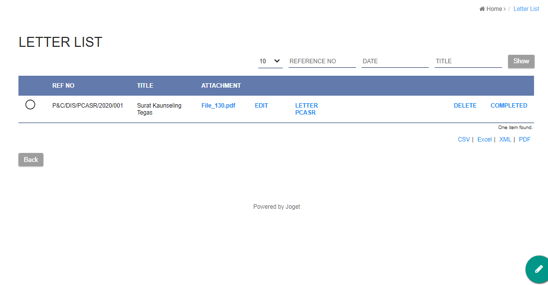

I want to change status letter from incomplete to completed when I clicked the completed button.
How can I do that?

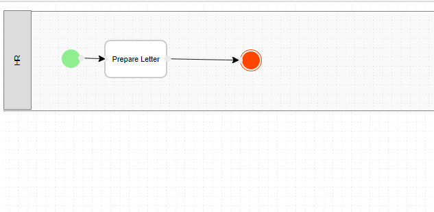

do I need to modify my workflow?

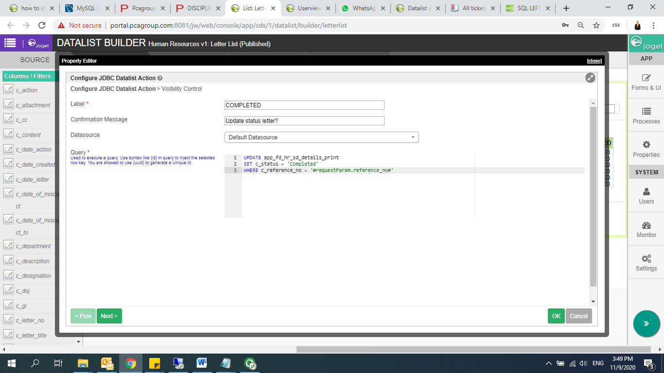

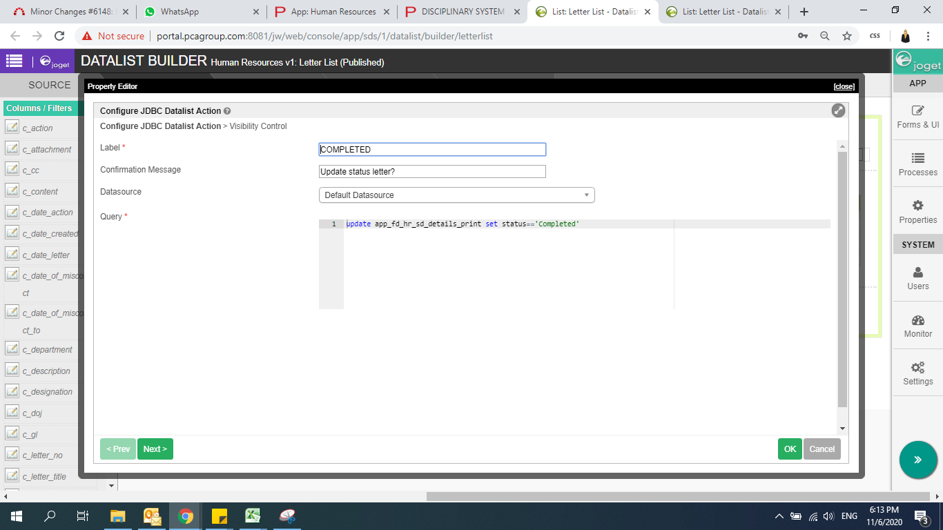

        Did I am doing wrong? Because the query does not works.
        UPDATE
        app_fd_hr_sd_details_print
        SET
        c_status =='Completed'
        WHERE
        c_reference_no = '#requestParam.reference_no#'
        I want to set everytime user clicked the button completed based on that reference_no, the c_status will be updated to Completed.
      3. Matthew King
        The SET syntax is wrong, should be ( read here for more information):
        UPDATE app_fd_hr_sd_details_print
        SET c_status = 'Completed'
        WHERE c_reference_no = '#requestParam.reference_no#'
        You can also try ".... WHERE c_reference_no = ? ".
      4. Nadh
        I have tried the query but still it does not work. the c_status does not updated from NULL to Completed
