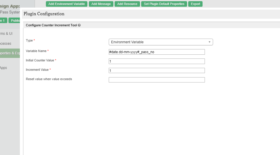

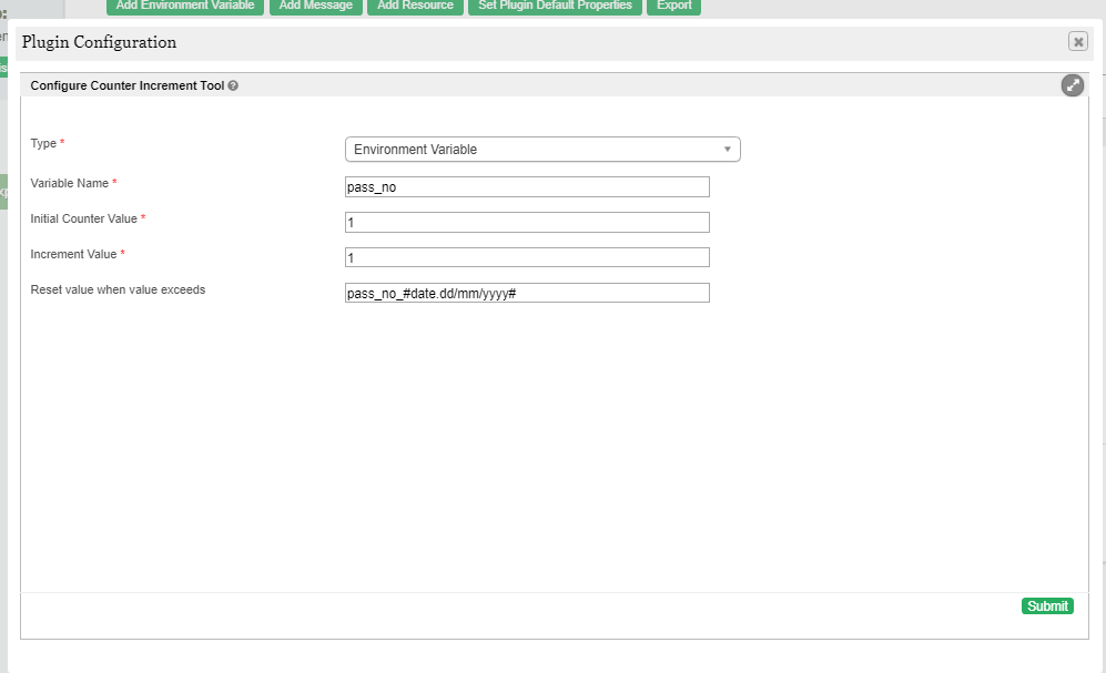

Should I need to put the hash variable in variable name?
#date.dd-mm-yyyy#_pass_no
This is my code since I want to reset the pass_no.. then I'll try to submit form again. The pass_no still not being reset to 001 - Chris Angel

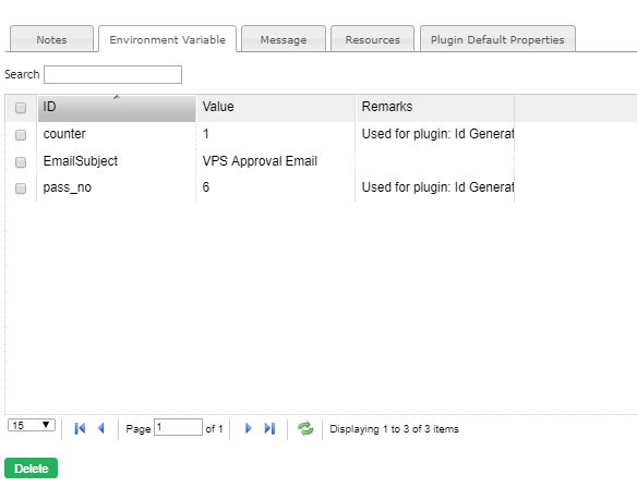

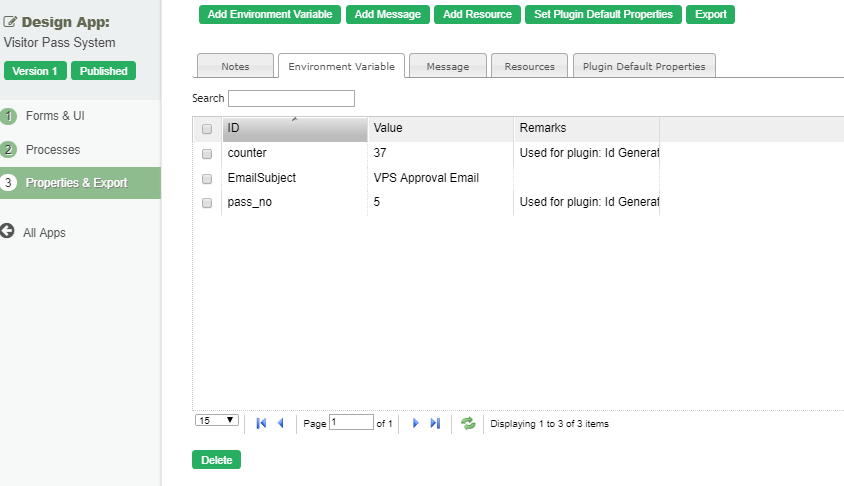

This is my counter increment tool. I have follow as Justin suggested.
but my pass_no still does not reset to 1. It still increase by 1.
- Chris Angel

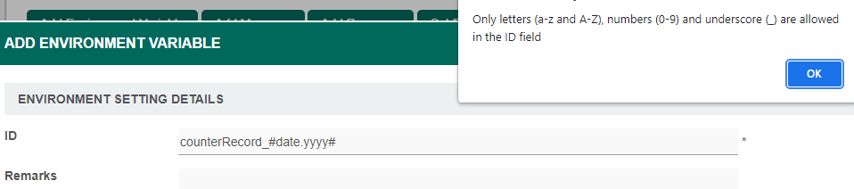

I tried implement your method, however I cannot create the environment Variable Name with '#'. I am using version DX7 Enterprise Trial.

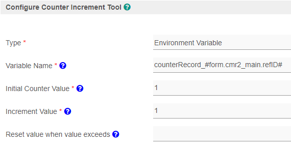

Hi Danial,
You don't need to create the environment variable beforehand. Simply key in this value with hash variable in "Variable Name" property in Counter Increment Tool. The plugin will auto generate the environment variable.

Hi Chris
Thanks. It's working now.

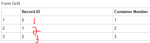

But I have another question. How do I start the counter 1 instead of 0.
I have already initial counter value as 1, but it still starts at zero. I want it to be like the red numbering.
In addition, it is possible to add text before the environmental variable? for example:
Row1 → CMR-01Row2 → CMR-02
Row3 → CMR-03
