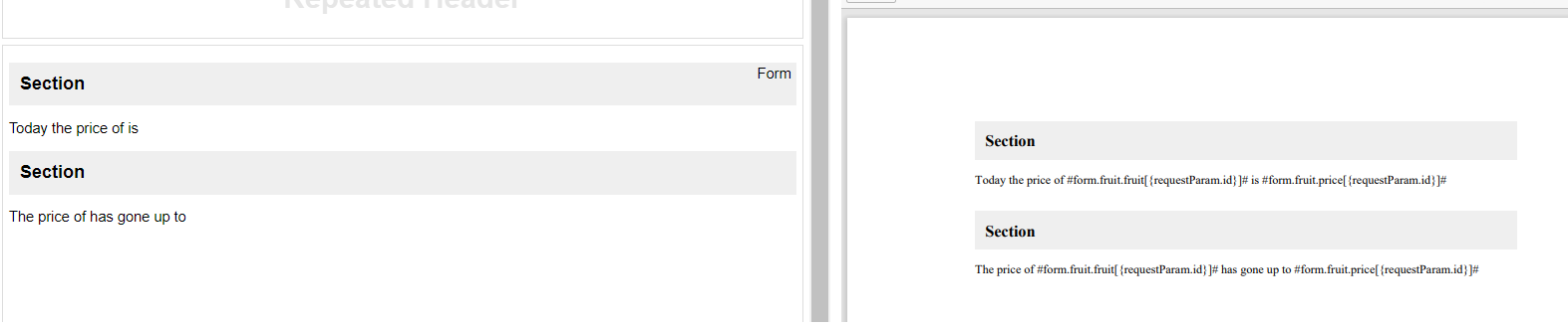

        I don't think a stored record containing hash variables can be parsed.
        What I could think of as a workaround is using a Form Element in the Report Builder.
        Within the form, separate it by section. Each section contains the text/paragraph in Custom HTML. Use the section visibility to control which text/paragraph to display. The custom HTML would contain the text/paragraph as well as the 30 hash variables.
        This requires you to pass parameters though...sorry
