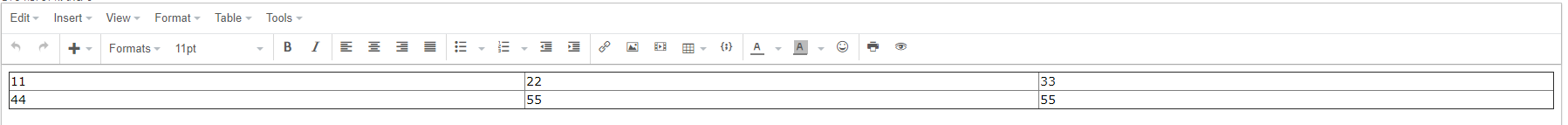

For example, I insert one table in it as below:
But when I run its Email tool, the border is missing in mail:

I created one rich text editor in form as Email Tool. But I found when I insert into one table via Rich Text Editor, and sent as mail, the table border is missing in mail subject. But the border is existing in rich text editor. How could I set to keep the table border in email tool ?
