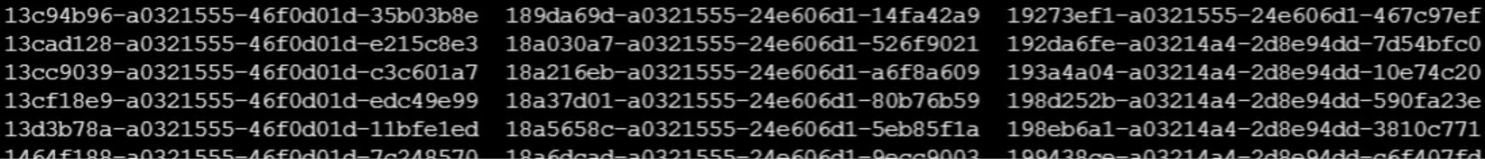

But I encounter a problem that I could not get the actual path that store the uploaded file. The way how joget store the uploaded file is like UUID (folder name) like screenshot below:

But the actual path that store the uploaded file is like below:
/home/jboss/wflow/app_formuploads/stao_form_filling_03/192da6fe-a03214a4-2d8e94dd-7d54bfc0/download.PNG
