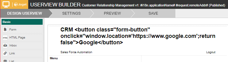

HI, u can edit the userview name and add in your custom HTML codes, for example:
CRM <button class="form-button" onclick="window.location='https://www.google.com';return false">Google</button>

Ok thanks. It looks to me that this editor was not meant to add a lot of code. I have quite a lot of code and logic to add and everything is showing up as bold with extra large characters (as in your example) filling up the view port. Does not look like that editor was meant for that purpose.
I am using the DX progressive theme. I need to customize the navigation bar (see image below) in the userview to add language switch button and svg code. Is that possible and if yes how?
