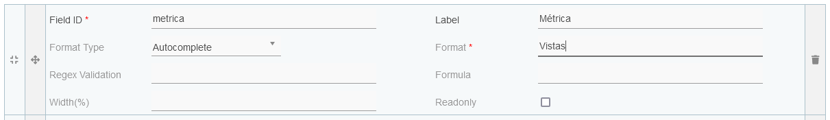

I need to make use of the "lazy mode" in a spreadsheet in Joget DX, in which "user can choose one of the suggested options while typing or enter a custom value that is not included in the suggestions.". The official documentation sends me to https://handsontable.com/docs/6.2.0/demo-autocomplete.html, however I do not find any relationship with the fields that the editor shows me in Joget. The only thing I could figure out is that the "Format" field must contain the name of the form in which it is, for example, a select box with the list of possible values.
However, when I go to the preview of the form, it is impossible for me to write a different value than the default ones in the list, always clearing the field after writing. Have you used this component before for this "mixed" use between list values and new values?
      Hi, I do not think this is currently supported in the spreadsheet element, because it validates to make sure that the values are specified in the available options.
