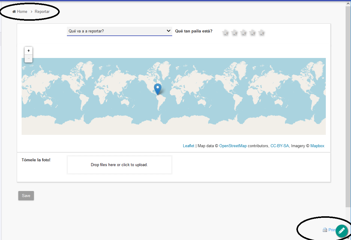

Hello team.
I am making an application that is almost going to be used 100% through mobile devices. I have two specific questions that would seem obvious, but no. How do I remove the "breadcrumb" item from the top of the screen? (It is enabled by default, I cannot find it in any option in the userview configuration). Also, how do I remove the "Print" option from the bottom?
Regards!

      To remove breadcrumbs, go to "Userview Builder > Settings" and look for this property Remove Auto Title from Process/Assignment form? and check this box.
      To hide the print button, you can use jQuery in a form Custom HTML:
      <script>
      $(function(){
            $(".print-button").hide();
      </script>
      1. Camilo A. García
        Hello, it was possible to complement this same answer, putting the following code directly in the custom java script section at the userview level:
        $(function(){
        $(".breadcrumb").hide();
