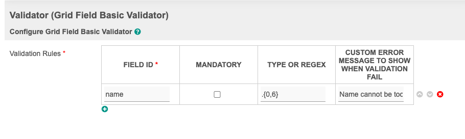

Scroll down to validator, choose Grid Field Basic Validator
Example, you want to limit "name" field to max 6 chars.
- Issa
I tried this solution but he can write in the cell more than the maxLength and then the validator will alert that the spreadsheet has a cell that exceeds its limit but it will not notify the user which cell, so if I have a spreadsheet of 1000 cells the user must check all cells manually

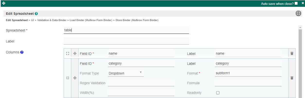

How to set maxLength to a spreadsheet cell
