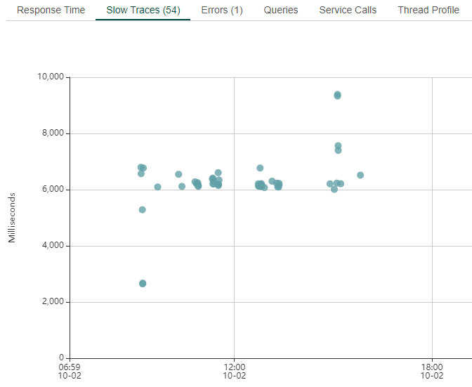

        Only about 4000 rows! Here is a snapshot of my slow trace. The query time between 6 and 10 seconds. About 1.5-2 seconds when done directly on DB.
