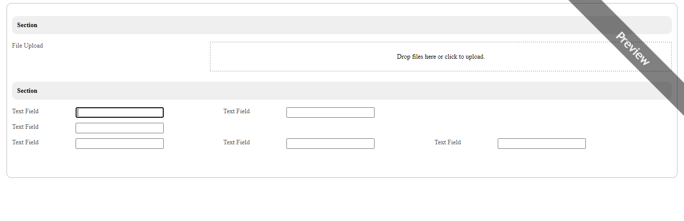

About the first part, you can see the attached picture.

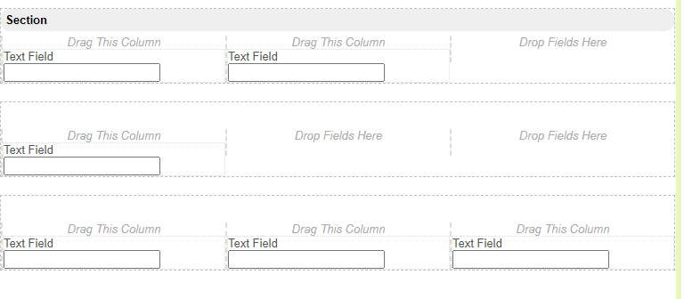

about the 2nd part, no you can't have different number of columns in the same section. You have to add a new section, remove its heading. It will look as it is the same column- CF
Can you please explain how you achieved this? When I do the drag and drop on the form builder I get
Field1 Field2 Field6
Field3 Field5
Field4
How to maintain the vertical space between Field2 and Field5?
- Anas Misbah Shami
On the right top corner of the section, from where you can copy or delete a section, there is another button to add column. You can use that
- CF
I did use the "Add Column" button to add my 3 columns. However my problem is that I cannot find any way to add the vertical space between field2 and field5. How were you able to do that? Are you using one section or three sections?
- Anas Misbah Shami
Three sections. I removed the label of the section
- CF
Ah ok. This is not exactly the solution that I was looking for as I needed this in a single section. The reason is that I am also using Section Tabs which does not support more than one section inside a tab. Thank you for your quick response.
I need to group similar fields together on one row on a form. How can I achieve the following layout in a single section?
3 columns and 3 rows. You will notice that field5 and field6 are at the same level as field4.
Section1
Field1 Field2
Field3
Field4 Field5 Field6
And a related question, can we have rows with different number of columns within one section?
