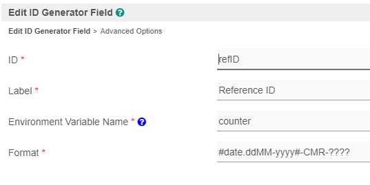

I have created an Reference ID with ID Generator field and it is work. However, I want to change it so that the counter reset by day.
For example on 2nd November, there were 36 forms submitted. so the reference ID is up to 0211-2021-CMR-000036. Tomorrow, when another form is submitted, the reference ID should reset to 0311-2021-CMR-000001. But instead in my case, it just continues to 37, 38 and so on. This could be due to me using a counter. I read previously that I need to use HASH variable, but I am not sure how.

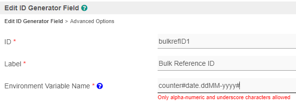

        In "environment variable name", set it to "counter#date.ddMM-yyyy#"
        Meaning, every new day, it will use new variable and it starts with 0.

          Hi
          Regarding your answer, Joget does not accept symbol either than underscore in their env. var. name.

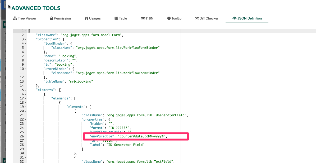

        2. Bastiana
          Go to adv tools > json defintion
          Set it directly into the property.
