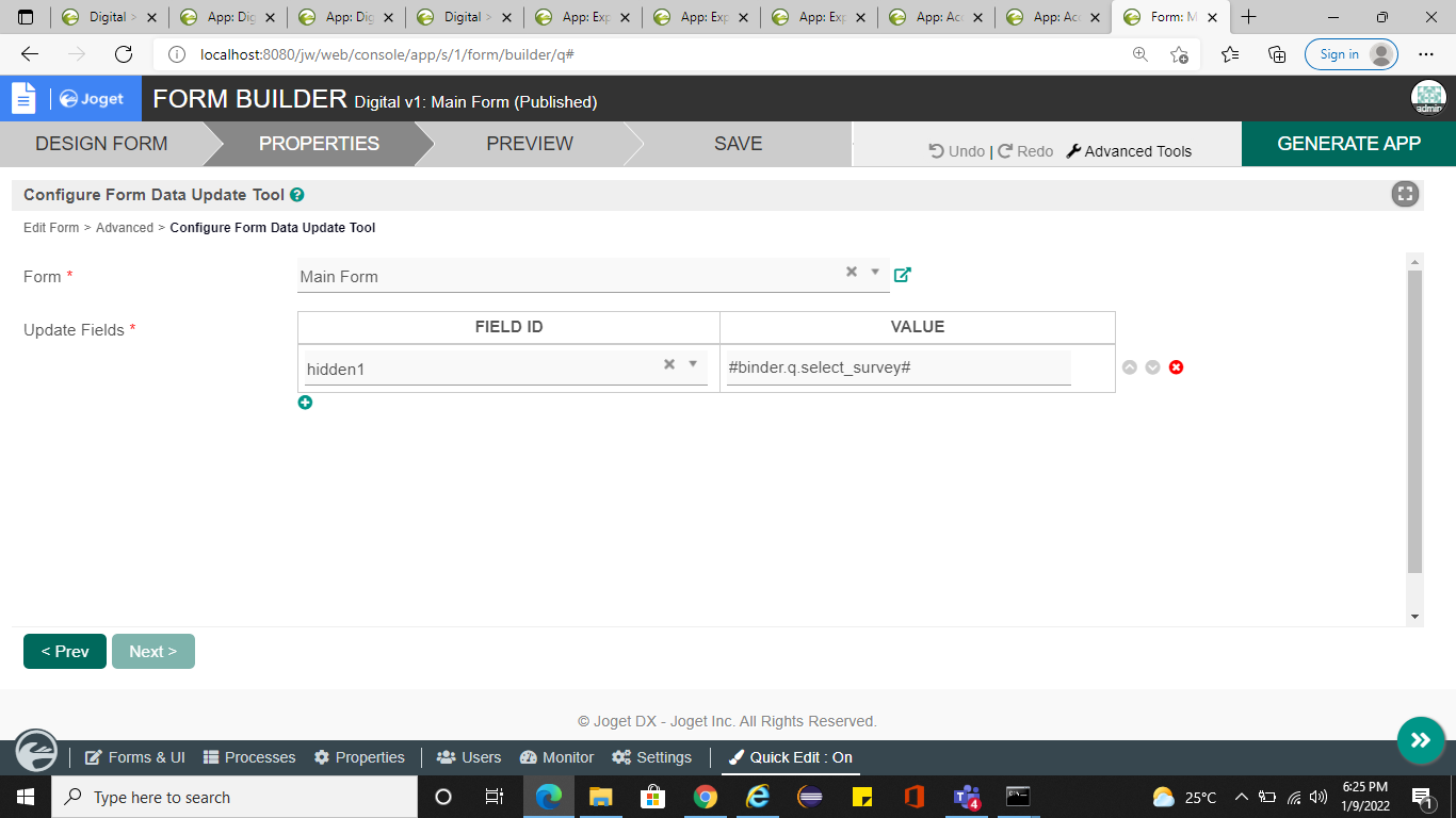

How to pass "calculation field values" to hidden fields? on different forms
this is the syntax I used to fetch values from "select box" and the same syntax we can use  for "check box" fields.
but what is the syntax to fetch values from "calculation fields"????
      I got the proper result.
      1.copy calculation field from form1 and form2 and paste it in to main_form.
      2. Now update form data tool in main_form by using hashvariable h1=  #form.main_form.ps# , h2= #form.main_form.ps2#
      This will work for sure : )
      If you  found any different solution please do share.
        consider using form data hash variable. #form.[form table name].[calculation field field ID]#
         https://dev.joget.org/community/display/DX7/Hash+Variable#HashVariable-FormDataHashVariable

          I am using "multipaged form"   and I am trying to call q_process (table name ) in that multipage form.
          table name of multipaged form is -"main_form"
          I am using above syntax #form.q_process.ps# in main_form [here I am calling q_process in main_form why because calculation field id (ps) present in q_process.
        4. Sanjana KL
          above syntax will work for particular form
          But I want to fetch calculation field values from form_1 and I need to store the same values into  the hidden_field of main_form.

        6. Sanjana KL
          note1, note 2 is correct and perfect .
          note3: main_form contain hidden value.
          and the scenario repeats for form2 also
          main_form contains two hidden field values h1,h2
          form1 have [calculation field id] i,e ps
          form2 have [calculation field id] i,e ps2
          and I am trying to assign the value  "ps" to h1  and same "ps2" to h2. by using form data update tool
