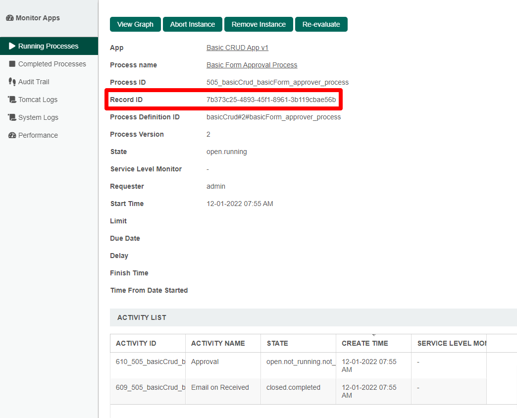

You can locate it at the monitor page itself
Monitor > Running Processes > Select the specific running process- ayohmang

how to locate recordid ?
