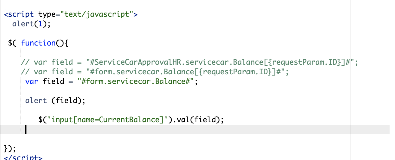

How to call value from other table using Javascript API
Hello.. im try to display the data from table using javascript. But its not work..I'm refer this.

        1. aimi

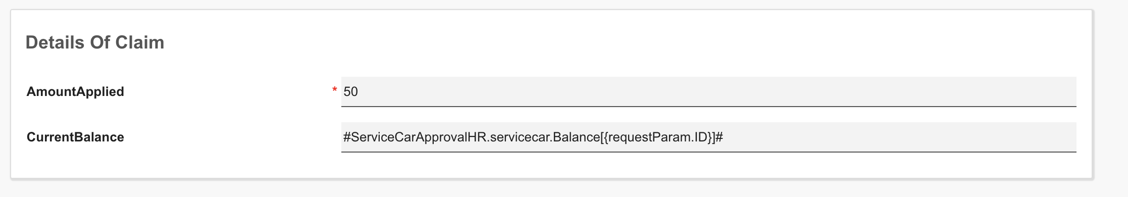

          Current balance is textbox, so im using javascript. When i try call Amount Applied (in same form) using
          "#form.servicecar.AmountApplied#" its work. But when i call field balance from another form but same table, its not work.
