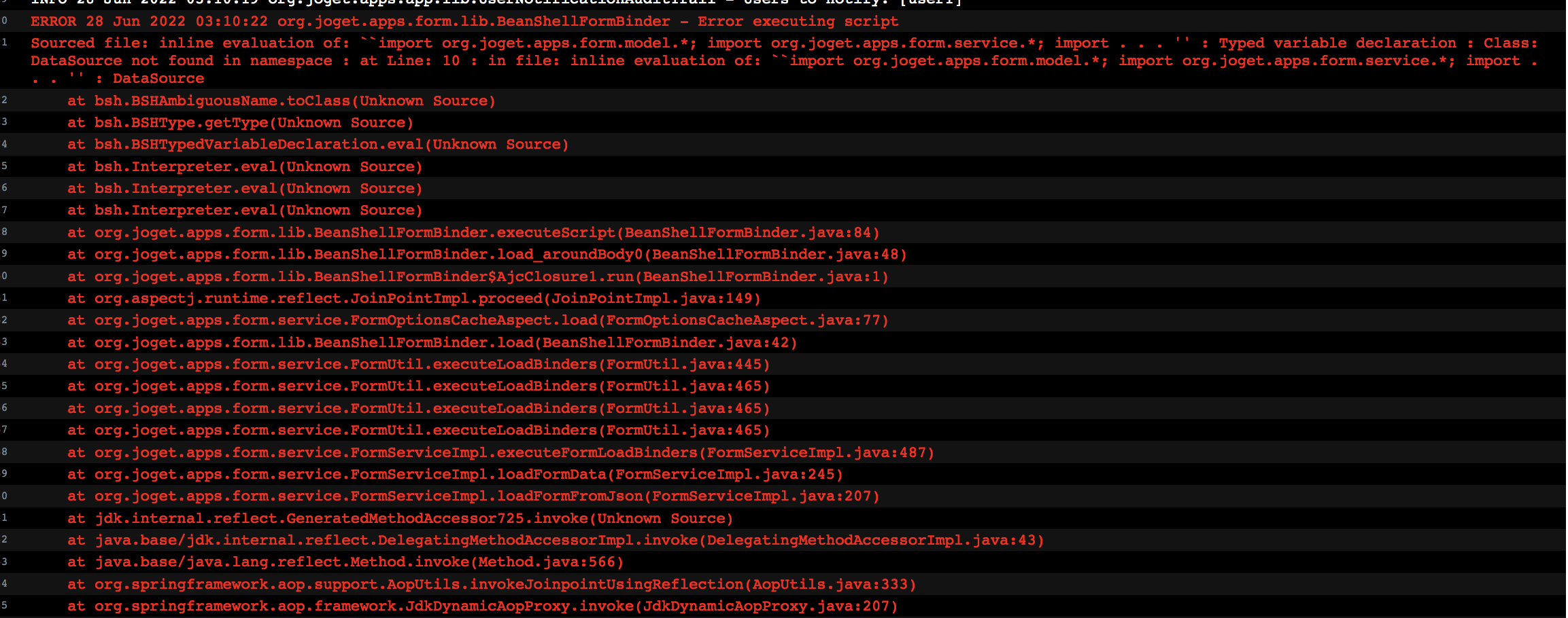

I want to insert Quantity in grid listing, but when i insert the record and Click Submit button , the error message displayed as below. For load grid im using JDBC, and for store the data using Bean Shell form binder.
I'm already  refer this link below. Anyone can help me?

      says in your error log there's "class: Datasource not found in namespace" in one of your beanshell form binder. Did you import the class into the beanshell? import javax.sql.DataSource;

        Saw the error log, can you check whether you have import javax.sql.DataSource;
        in your bean shell? If not, add it and see if it works?
        Try removing 1 bean shell just to identify where is the error located, either in load or store

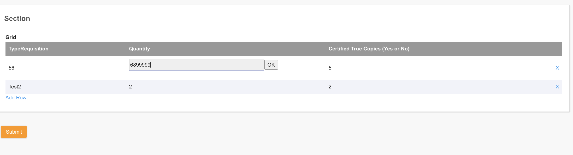

        1) Key in TypeRequisition form.
        2) Click Company Secretary Form.  grid will display data from table Type Requisition.(Its my problem now, error when load & Store form binder).
        3) Key in the record and click submit button.
        * When click submit button, record in grid listing not update also.

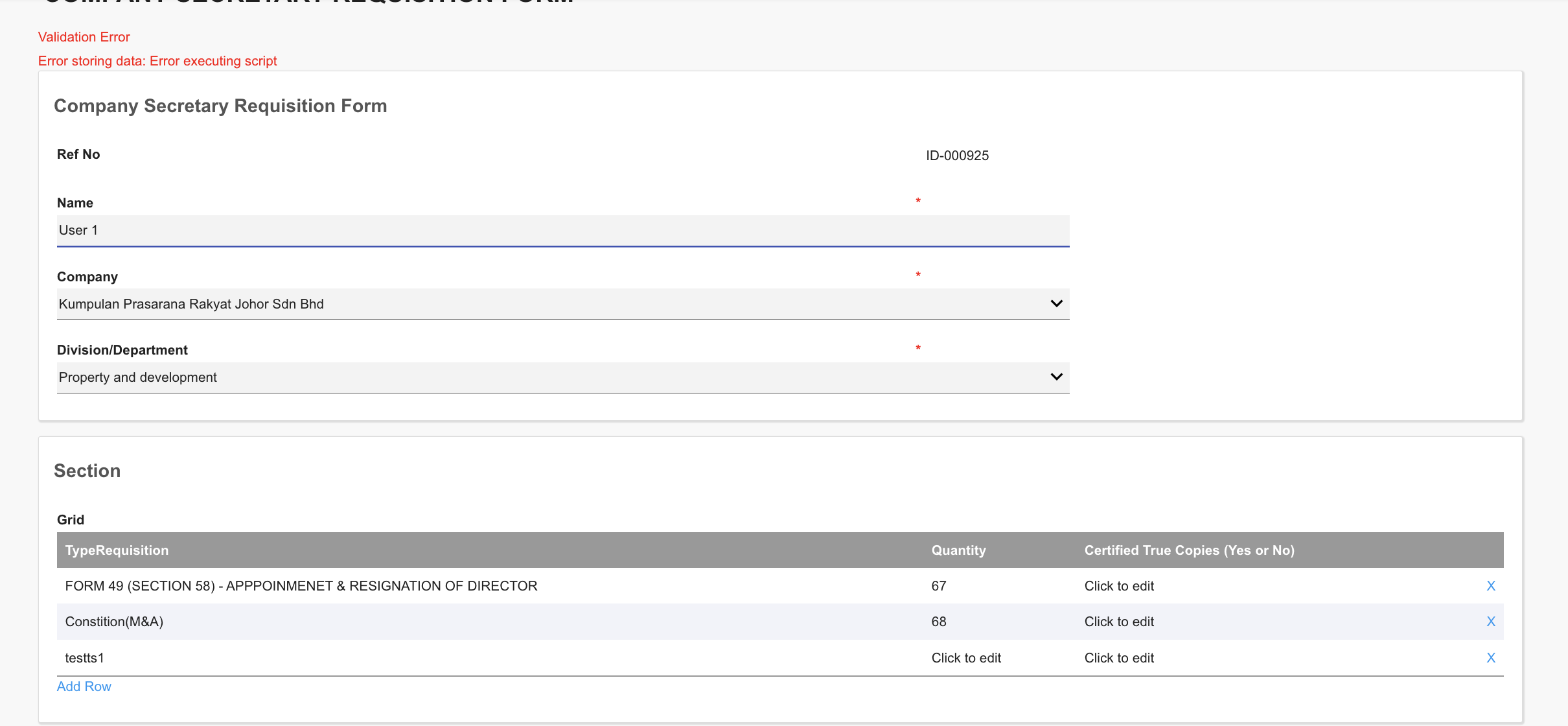

        Hi Ian, Thanks a lot for load binder bean shell successful. But for store binder bean shell still problem. I want to display all data from table Type Requisition to grid listing in form Secretary Requisition Form. When i update the record in grid listing, displayed error message.
      8. Ian
        Yeah for storing the grid listing it's basically a 1-to-many relationship i.e 1 Company Secretary Requisition Form has many type requisitions. You'll need a foreign key and possibly another table so whatever you update the grid, it won't affect typerequisition table.
        One-to-Many Relationships in a Database (lifewire.com)
        Again, my suggestion is use Joget's Enterprise Edition. There's a plugin that makes things a whole lot easier where you don't have to write a beanshell for it. All you need is a hidden field as a foreign key and point to the form.
        Grid#DataBinder-MultirowFormBinder
