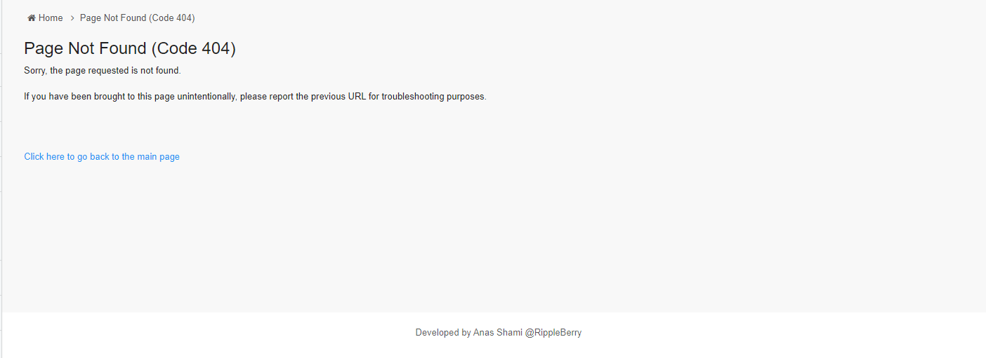

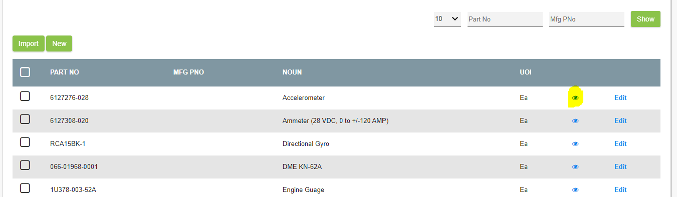

Attached are the 2 pics. 1st pic contains the list on which there is a view form button (eye icon). Upon clicking eye icon, a view form opens. The form content is not permitted to the logged in user (Shown in figure 2). I want to hide the view (eye icon) from the row action based on permission configuration.
FIgure 1: List with eye icon
Figure 2: Form not accessible
