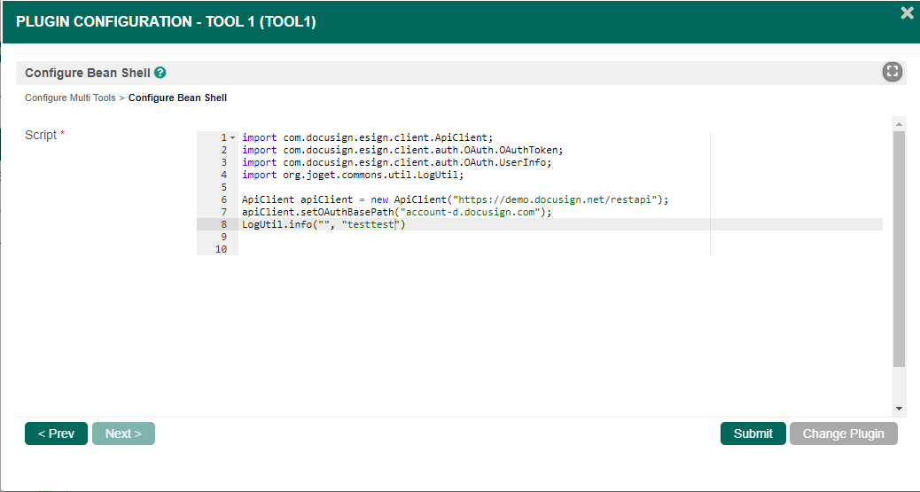

Hi, the error "Caused by: java.lang.ClassNotFoundException: com.fasterxml.jackson.databind.util.ISO8601DateFormat" indicates that a specific class is missing due to an incompatible library version. You can try to use a compatible library version, or wrap the functionality within your own plugin so that you can use your own dependency versions.
Hello, I am getting this error whenever I call ApiClient apiClient = new ApiClient();
The error I usually get before is that it uses Java runtime 55 instead of 52, however after downgrading the jar I got another error (even after upgrading it again) I still get this error.

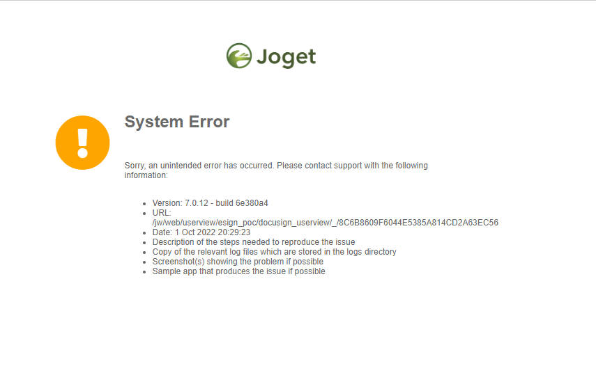

Joget DX Enterprise Version: 7.0.12
System Error
Sorry, an unintended error has occurred. Please contact support with the following information:

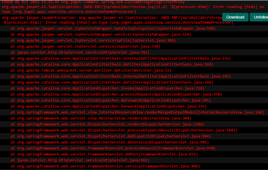

ERROR 01 Oct 2022 09:54:30 org.joget.commons.spring.web.CustomDelegatingFilterProxy - org.apache.jasper.el.JspELException: /WEB-INF/jsp/ubuilder/v5view.jsp(11,4) '${processer.html}' Error reading [html] on type [org.joget.apps.userview.service.UserviewThemeProcesser]
org.apache.jasper.JasperException: org.apache.jasper.el.JspELException: /WEB-INF/jsp/ubuilder/v5view.jsp(11,4) '${processer.html}' Error reading [html] on type [org.joget.apps.userview.service.UserviewThemeProcesser]
at org.apache.jasper.servlet.JspServletWrapper.handleJspException(JspServletWrapper.java:598)
at org.apache.jasper.servlet.JspServletWrapper.service(JspServletWrapper.java:514)
at org.apache.jasper.servlet.JspServlet.serviceJspFile(JspServlet.java:386)
at org.apache.jasper.servlet.JspServlet.service(JspServlet.java:330)
at javax.servlet.http.HttpServlet.service(HttpServlet.java:742)
at org.apache.catalina.core.ApplicationFilterChain.internalDoFilter(ApplicationFilterChain.java:231)
at org.apache.catalina.core.ApplicationFilterChain.doFilter(ApplicationFilterChain.java:166)
at org.apache.tomcat.websocket.server.WsFilter.doFilter(WsFilter.java:52)
at org.apache.catalina.core.ApplicationFilterChain.internalDoFilter(ApplicationFilterChain.java:193)
at org.apache.catalina.core.ApplicationDispatcher.invoke(ApplicationDispatcher.java:728)
at org.apache.catalina.core.ApplicationDispatcher.processRequest(ApplicationDispatcher.java:470)
at org.apache.catalina.core.ApplicationDispatcher.doForward(ApplicationDispatcher.java:395)
at org.apache.catalina.core.ApplicationDispatcher.forward(ApplicationDispatcher.java:316)
at org.springframework.web.servlet.view.InternalResourceView.renderMergedOutputModel(InternalResourceView.java:168)
at org.springframework.web.servlet.view.AbstractView.render(AbstractView.java:304)
at org.springframework.web.servlet.DispatcherServlet.render(DispatcherServlet.java:1286)
at org.springframework.web.servlet.DispatcherServlet.processDispatchResult(DispatcherServlet.java:1041)
at org.springframework.web.servlet.DispatcherServlet.doDispatch(DispatcherServlet.java:984)
at org.springframework.web.servlet.DispatcherServlet.doService(DispatcherServlet.java:901)
at org.springframework.web.servlet.FrameworkServlet.processRequest(FrameworkServlet.java:970)
at org.springframework.web.servlet.FrameworkServlet.doPost(FrameworkServlet.java:872)
at javax.servlet.http.HttpServlet.service(HttpServlet.java:661)
at org.springframework.web.servlet.FrameworkServlet.service(FrameworkServlet.java:846)
at org.joget.apps.app.web.GitRequestFilter.doFilter(GitRequestFilter.java:40)
at org.joget.commons.util.AnalyzerFilter.doFilter_aroundBody0(AnalyzerFilter.java:17)
at org.joget.commons.util.AnalyzerFilter$AjcClosure1.run(AnalyzerFilter.java:1)
at org.aspectj.runtime.reflect.JoinPointImpl.proceed(JoinPointImpl.java:149)
at org.joget.commons.util.AnalyzerAspect.analyzeRequests(AnalyzerAspect.java:54)
at org.joget.commons.util.AnalyzerFilter.doFilter(AnalyzerFilter.java:17)
at org.displaytag.filter.ResponseOverrideFilter.doFilter(ResponseOverrideFilter.java:125)
at org.owasp.csrfguard.CsrfGuardFilter.doFilter(CsrfGuardFilter.java:88)
at org.springframework.security.web.FilterChainProxy$VirtualFilterChain.doFilter(FilterChainProxy.java:317)
at org.springframework.security.web.access.intercept.FilterSecurityInterceptor.invoke(FilterSecurityInterceptor.java:127)
at org.springframework.security.web.access.intercept.FilterSecurityInterceptor.doFilter(FilterSecurityInterceptor.java:91)
at org.springframework.security.web.FilterChainProxy$VirtualFilterChain.doFilter(FilterChainProxy.java:331)
at org.springframework.security.web.access.ExceptionTranslationFilter.doFilter(ExceptionTranslationFilter.java:115)
at org.springframework.security.web.session.SessionManagementFilter.doFilter(SessionManagementFilter.java:137)
at org.springframework.security.web.authentication.AnonymousAuthenticationFilter.doFilter(AnonymousAuthenticationFilter.java:111)
at org.springframework.security.web.savedrequest.RequestCacheAwareFilter.doFilter(RequestCacheAwareFilter.java:63)
at org.springframework.security.web.authentication.AbstractAuthenticationProcessingFilter.doFilter(AbstractAuthenticationProcessingFilter.java:200)
at org.joget.apps.workflow.security.WorkflowHttpAuthProcessingFilter.doFilter(WorkflowHttpAuthProcessingFilter.java:86)
at org.springframework.security.web.authentication.www.BasicAuthenticationFilter.doFilterInternal(BasicAuthenticationFilter.java:158)
at org.springframework.web.filter.OncePerRequestFilter.doFilter(OncePerRequestFilter.java:107)
at org.springframework.security.web.authentication.logout.LogoutFilter.doFilter(LogoutFilter.java:121)
at org.springframework.security.web.header.HeaderWriterFilter.doFilterInternal(HeaderWriterFilter.java:66)
at org.springframework.security.web.context.request.async.WebAsyncManagerIntegrationFilter.doFilterInternal(WebAsyncManagerIntegrationFilter.java:56)
at org.springframework.security.web.context.SecurityContextPersistenceFilter.doFilter(SecurityContextPersistenceFilter.java:105)
at org.springframework.security.web.FilterChainProxy.doFilterInternal(FilterChainProxy.java:214)
at org.springframework.security.web.FilterChainProxy.doFilter(FilterChainProxy.java:177)
at org.springframework.web.filter.DelegatingFilterProxy.invokeDelegate(DelegatingFilterProxy.java:347)
at org.springframework.web.filter.DelegatingFilterProxy.doFilter(DelegatingFilterProxy.java:263)
at org.joget.commons.spring.web.CustomDelegatingFilterProxy.doFilter(CustomDelegatingFilterProxy.java:31)
at org.joget.apps.app.web.ExpireFilter.doFilter(ExpireFilter.java:48)
at org.springframework.web.filter.CharacterEncodingFilter.doFilterInternal(CharacterEncodingFilter.java:197)
at org.apache.catalina.core.StandardWrapperValve.invoke(StandardWrapperValve.java:199)
at org.apache.catalina.core.StandardContextValve.invoke(StandardContextValve.java:96)
at org.apache.catalina.authenticator.AuthenticatorBase.invoke(AuthenticatorBase.java:493)
at org.apache.catalina.core.StandardHostValve.invoke(StandardHostValve.java:137)
at org.apache.catalina.valves.ErrorReportValve.invoke(ErrorReportValve.java:81)
at org.apache.catalina.core.StandardEngineValve.invoke(StandardEngineValve.java:87)
at org.apache.catalina.connector.CoyoteAdapter.service(CoyoteAdapter.java:343)
at org.apache.coyote.http11.Http11Processor.service(Http11Processor.java:798)
at org.apache.coyote.AbstractProcessorLight.process(AbstractProcessorLight.java:66)
at org.apache.coyote.AbstractProtocol$ConnectionHandler.process(AbstractProtocol.java:808)
at org.apache.tomcat.util.net.NioEndpoint$SocketProcessor.doRun(NioEndpoint.java:1498)
at org.apache.tomcat.util.net.SocketProcessorBase.run(SocketProcessorBase.java:49)
at java.util.concurrent.ThreadPoolExecutor.runWorker(ThreadPoolExecutor.java:1149)
at java.util.concurrent.ThreadPoolExecutor$Worker.run(ThreadPoolExecutor.java:624)
at org.apache.tomcat.util.threads.TaskThread$WrappingRunnable.run(TaskThread.java:61)
at java.lang.Thread.run(Thread.java:748)
Caused by: org.apache.jasper.el.JspELException: /WEB-INF/jsp/ubuilder/v5view.jsp(11,4) '${processer.html}' Error reading [html] on type [org.joget.apps.userview.service.UserviewThemeProcesser]
at org.apache.jasper.el.JspValueExpression.getValue(JspValueExpression.java:123)
at org.apache.jsp.WEB_002dINF.jsp.ubuilder.v5view_jsp._jspx_meth_c_005fset_005f0(v5view_jsp.java:250)
at org.apache.jsp.WEB_002dINF.jsp.ubuilder.v5view_jsp._jspx_meth_c_005fif_005f0(v5view_jsp.java:207)
at org.apache.jsp.WEB_002dINF.jsp.ubuilder.v5view_jsp._jspService(v5view_jsp.java:158)
at org.apache.jasper.runtime.HttpJspBase.service(HttpJspBase.java:70)
at org.apache.jasper.servlet.JspServletWrapper.service(JspServletWrapper.java:476)
... 104 more
Caused by: java.lang.NoClassDefFoundError: com/fasterxml/jackson/databind/util/ISO8601DateFormat
at java.lang.ClassLoader.defineClass1(Native Method)
at java.lang.ClassLoader.defineClass(ClassLoader.java:757)
at java.security.SecureClassLoader.defineClass(SecureClassLoader.java:142)
at java.net.URLClassLoader.defineClass(URLClassLoader.java:468)
at java.net.URLClassLoader.access$100(URLClassLoader.java:74)
at java.net.URLClassLoader$1.run(URLClassLoader.java:369)
at java.net.URLClassLoader$1.run(URLClassLoader.java:363)
at java.security.AccessController.doPrivileged(Native Method)
at java.net.URLClassLoader.findClass(URLClassLoader.java:362)
at java.lang.ClassLoader.loadClass(ClassLoader.java:419)
at java.lang.ClassLoader.loadClass(ClassLoader.java:352)
at java.lang.Class.getDeclaredConstructors0(Native Method)
at java.lang.Class.privateGetDeclaredConstructors(Class.java:2671)
at java.lang.Class.getConstructors(Class.java:1651)
at bsh.Reflect.constructObject(Unknown Source)
at bsh.BSHAllocationExpression.constructObject(Unknown Source)
at bsh.BSHAllocationExpression.objectAllocation(Unknown Source)
at bsh.BSHAllocationExpression.eval(Unknown Source)
at bsh.BSHPrimaryExpression.eval(Unknown Source)
at bsh.BSHVariableDeclarator.eval(Unknown Source)
at bsh.BSHTypedVariableDeclaration.eval(Unknown Source)
at bsh.Interpreter.eval(Unknown Source)
at org.joget.apps.app.lib.BeanShellTool.executeScript_aroundBody16(BeanShellTool.java:68)
at org.joget.apps.app.lib.BeanShellTool.executeScript_aroundBody17$advice(BeanShellTool.java:99)
at org.joget.apps.app.lib.BeanShellTool.executeScript(BeanShellTool.java:1)
at org.joget.apps.app.lib.BeanShellTool.execute_aroundBody6(BeanShellTool.java:38)
at org.joget.apps.app.lib.BeanShellTool.execute_aroundBody7$advice(BeanShellTool.java:99)
at org.joget.apps.app.lib.BeanShellTool.execute(BeanShellTool.java:1)
at org.joget.apps.app.lib.MultiTools.execute_aroundBody12(MultiTools.java:130)
at org.joget.apps.app.lib.MultiTools.execute_aroundBody13$advice(MultiTools.java:99)
at org.joget.apps.app.lib.MultiTools.execute(MultiTools.java:1)
at org.joget.apps.app.service.AppWorkflowHelper.executeTool(AppWorkflowHelper.java:130)
at org.joget.workflow.shark.WorkflowToolActivityHandler.executeActivity(WorkflowToolActivityHandler.java:69)
at org.enhydra.shark.WfActivityImpl.runTool(WfActivityImpl.java:1487)
at org.enhydra.shark.WfActivityImpl.startActivity(WfActivityImpl.java:1419)
at org.enhydra.shark.WfActivityImpl.activate(WfActivityImpl.java:261)
at org.enhydra.shark.WfProcessImpl.startActivity(WfProcessImpl.java:918)
at org.enhydra.shark.WfProcessImpl.run(WfProcessImpl.java:742)
at org.enhydra.shark.WfProcessImpl.start(WfProcessImpl.java:422)
at org.enhydra.shark.WfProcessWrapper.start(WfProcessWrapper.java:289)
at org.joget.workflow.model.service.WorkflowManagerImpl.processStart(WorkflowManagerImpl.java:3127)
at org.joget.workflow.model.service.WorkflowManagerImpl.processStartWithInstanceId(WorkflowManagerImpl.java:3046)
at sun.reflect.GeneratedMethodAccessor537.invoke(Unknown Source)
at sun.reflect.DelegatingMethodAccessorImpl.invoke(DelegatingMethodAccessorImpl.java:43)
at java.lang.reflect.Method.invoke(Method.java:498)
at org.springframework.aop.support.AopUtils.invokeJoinpointUsingReflection(AopUtils.java:333)
at org.springframework.aop.framework.ReflectiveMethodInvocation.invokeJoinpoint(ReflectiveMethodInvocation.java:190)
at org.springframework.aop.framework.ReflectiveMethodInvocation.proceed(ReflectiveMethodInvocation.java:157)
at org.springframework.transaction.interceptor.TransactionInterceptor$1.proceedWithInvocation(TransactionInterceptor.java:99)
at org.springframework.transaction.interceptor.TransactionAspectSupport.invokeWithinTransaction(TransactionAspectSupport.java:283)
at org.springframework.transaction.interceptor.TransactionInterceptor.invoke(TransactionInterceptor.java:96)
at org.springframework.aop.framework.ReflectiveMethodInvocation.proceed(ReflectiveMethodInvocation.java:179)
at org.joget.apps.app.service.AuditTrailInterceptor.invoke(AuditTrailInterceptor.java:17)
at org.joget.apps.app.service.SqlFilterAspect.invoke(SqlFilterAspect.java:38)
at org.springframework.aop.interceptor.ExposeInvocationInterceptor.invoke(ExposeInvocationInterceptor.java:92)
at org.springframework.aop.framework.JdkDynamicAopProxy.invoke(JdkDynamicAopProxy.java:213)
at com.sun.proxy.$Proxy43.processStartWithInstanceId(Unknown Source)
at org.joget.apps.app.service.AppServiceImpl.submitFormToStartProcess(AppServiceImpl.java:745)
at sun.reflect.GeneratedMethodAccessor528.invoke(Unknown Source)
at org.springframework.aop.framework.JdkDynamicAopProxy.invoke(JdkDynamicAopProxy.java:207)
at com.sun.proxy.$Proxy49.submitFormToStartProcess(Unknown Source)
at org.joget.apps.userview.lib.RunProcess.startProcess_aroundBody24(RunProcess.java:360)
at org.joget.apps.userview.lib.RunProcess.startProcess_aroundBody25$advice(RunProcess.java:99)
at org.joget.apps.userview.lib.RunProcess.startProcess(RunProcess.java:1)
at org.joget.apps.userview.lib.RunProcess.getJspPage_aroundBody20(RunProcess.java:208)
at org.joget.apps.userview.lib.RunProcess.getJspPage_aroundBody21$advice(RunProcess.java:99)
at org.joget.apps.userview.lib.RunProcess.getJspPage(RunProcess.java:1)
at org.joget.apps.userview.model.UserviewMenu.getReadyJspPage_aroundBody12(UserviewMenu.java:134)
at org.joget.apps.userview.model.UserviewMenu.getReadyJspPage_aroundBody13$advice(UserviewMenu.java:99)
at org.joget.apps.userview.model.UserviewMenu.getReadyJspPage(UserviewMenu.java:1)
at org.joget.apps.userview.service.UserviewUtil.getUserviewMenuHtml(UserviewUtil.java:130)
at org.joget.apps.userview.service.UserviewThemeProcesser.getContent(UserviewThemeProcesser.java:643)
at org.joget.apps.userview.service.UserviewThemeProcesser.getHtml(UserviewThemeProcesser.java:197)
at sun.reflect.GeneratedMethodAccessor378.invoke(Unknown Source)
at javax.el.BeanELResolver.getValue(BeanELResolver.java:94)
at org.apache.jasper.el.JasperELResolver.getValue(JasperELResolver.java:110)
at org.apache.el.parser.AstValue.getValue(AstValue.java:169)
at org.apache.el.ValueExpressionImpl.getValue(ValueExpressionImpl.java:190)
at org.apache.jasper.el.JspValueExpression.getValue(JspValueExpression.java:115)
... 110 more
at java.net.URLClassLoader.findClass(URLClassLoader.java:382)
... 200 more
... 104 more
... 110 more

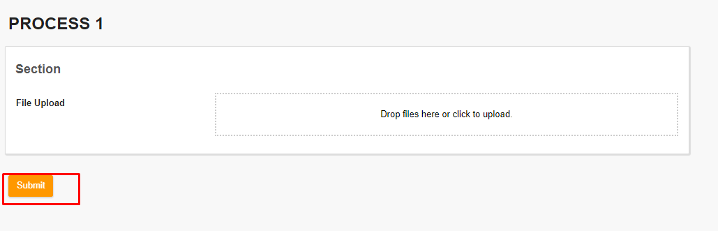

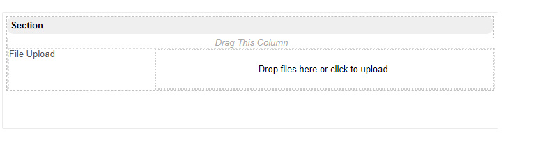

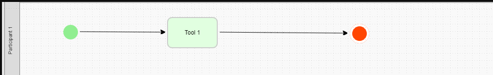

What are the steps to reproduce the error?
This is a simple example to reproduce this error:
I created a form with a FileUpload and linked it with a simple process, and inside the process I added a bean shell tool, with the code below.
//// running it
