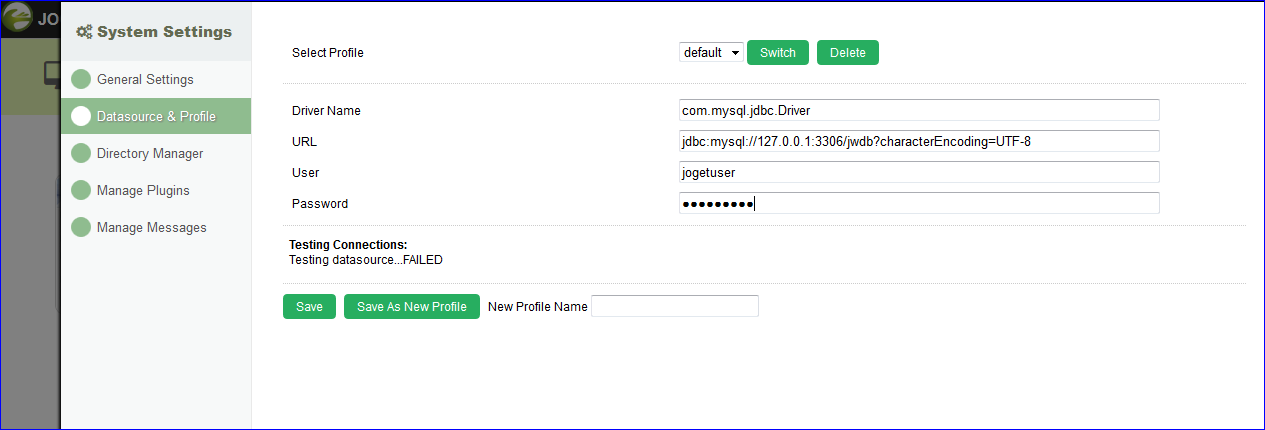

The error what I can see on admin UI

Hi ,
I encounter the below erros as mention on comman issue during instalation FAQ ( Setting Up Database) . but I could not find how to fix, did any one too encounter the same ? , Please help to share your findings
