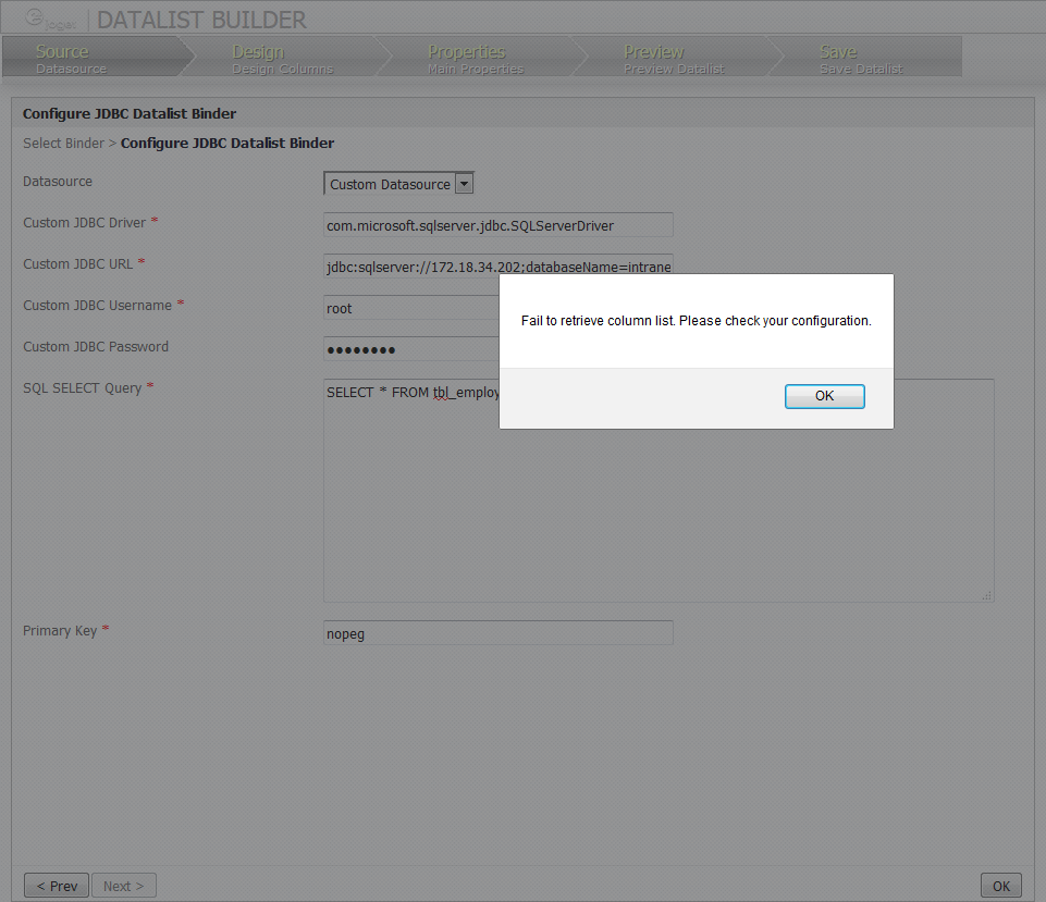

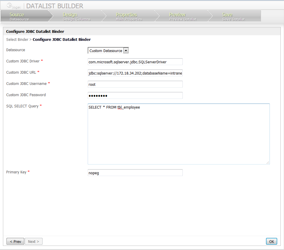

Hi Master Joget,
How to connection joget workflow with sql server 2008 R2, in configure data list binder i will be connect this database. i'am to try but error configure, help me please. please see this image in below :
      this is error log in joget log :

      How solution ya this case master hugo ? thank you for you attention
      1. Anders
        The error says "java.sql.SQLException: No suitable driver" which means that the JDBC driver cannot be found. Try checking to ensure that the SQL Server JDBC driver is in your classpath.
    2.
      You can try to check your server log for the error details.
