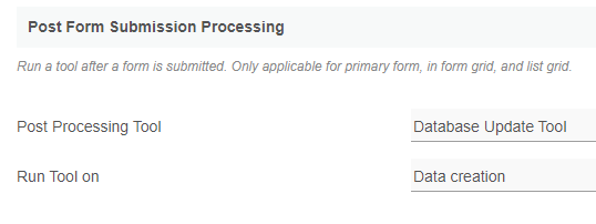

        Using the tool below
        My SQL statement in the Post Form Submission is like below (just copying some records from one table to another)
        insert into app_fd_fruit(id,c_name,c_color,c_price,c_parent)
        select {uuid},c_name,c_color,c_price, {id}
        from app_fd_fruit_db
        where c_color = "red"
          It may depend on the database engine, I think. I also have tried the example SQL in the KB documentation and it worked fine in MySQL and MariaDB databases.
