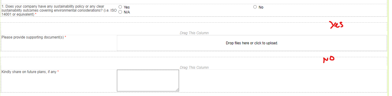

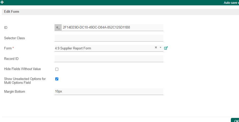

My  form got section rule and now i implement this form under report section. But when i review back the form using Download Report Plugin and pass the parameter id at datalist, the value (likes attachment and description) do not show in the form, even already have the data.
Report Builder Setting in Addon Builder Section
Form section that have section rule
      Hi, what is the Download Report Plugin that is mentioned? There is not enough information to understand the issue.
        I think you need to add the "#reportParam.id#" hash in the Record ID field property (in your first screenshot above) so that the record id is passed to the report builder to retrieve the correct record from the database.
